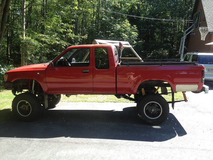

So I'm sorry I never posted what my final decision was. I ended up doing a solid axle swap. love it but there have been a few issues that im coming across now.
First off heres a pic of the truck after the swap.
I went with the wabbits 5 inch kit and did chevys for the rear and now im to tall. I need to find a way to lower it back down 2 inches so i can put 35s on the truck without exceeding lift laws in maine. the truck is sitting on 31s at the moment.
frame is 27 inches from ground in front 29 inches in rear the absolute max allowed in maine.
Is there any way i can drop it back down a bit without buying new spring packs. the rear i have adjustable shackles in the rear so it will be easier.

Wabbits kit is just the universal Trail-gear kit. Try pulling a leaf out, or search RUF springs. Your shackle angle looks good for the springs, so a flatter spring may require moving the front hanger forward or shorter shackles anyway.
If you wanted it to sit lower, then why did you get the 5" kit?

I did the 5 inch kit because i expected it to go up 5 inches. it ended up going up almost a foot. i guess my torsion bars were really sagging before the lift. when im home this weekend ill take a picture of the shackle angle. if i take out a leaf which one would you suggest out of the pack?

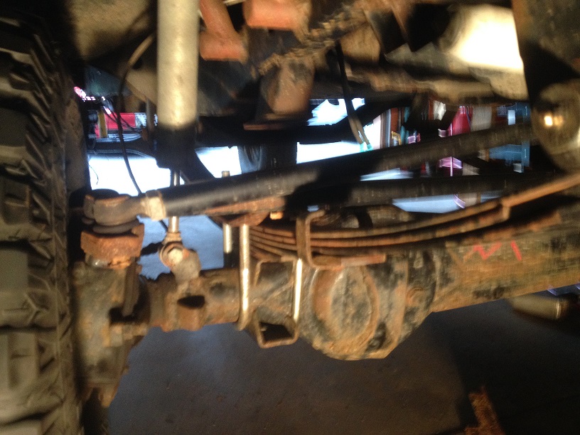

Probably the shortest, better pictures of your problem will net you better answers.

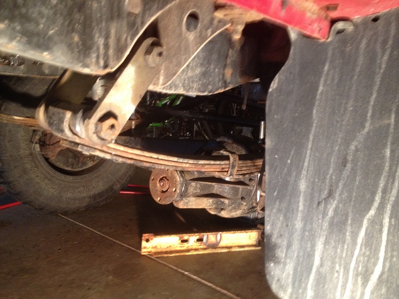

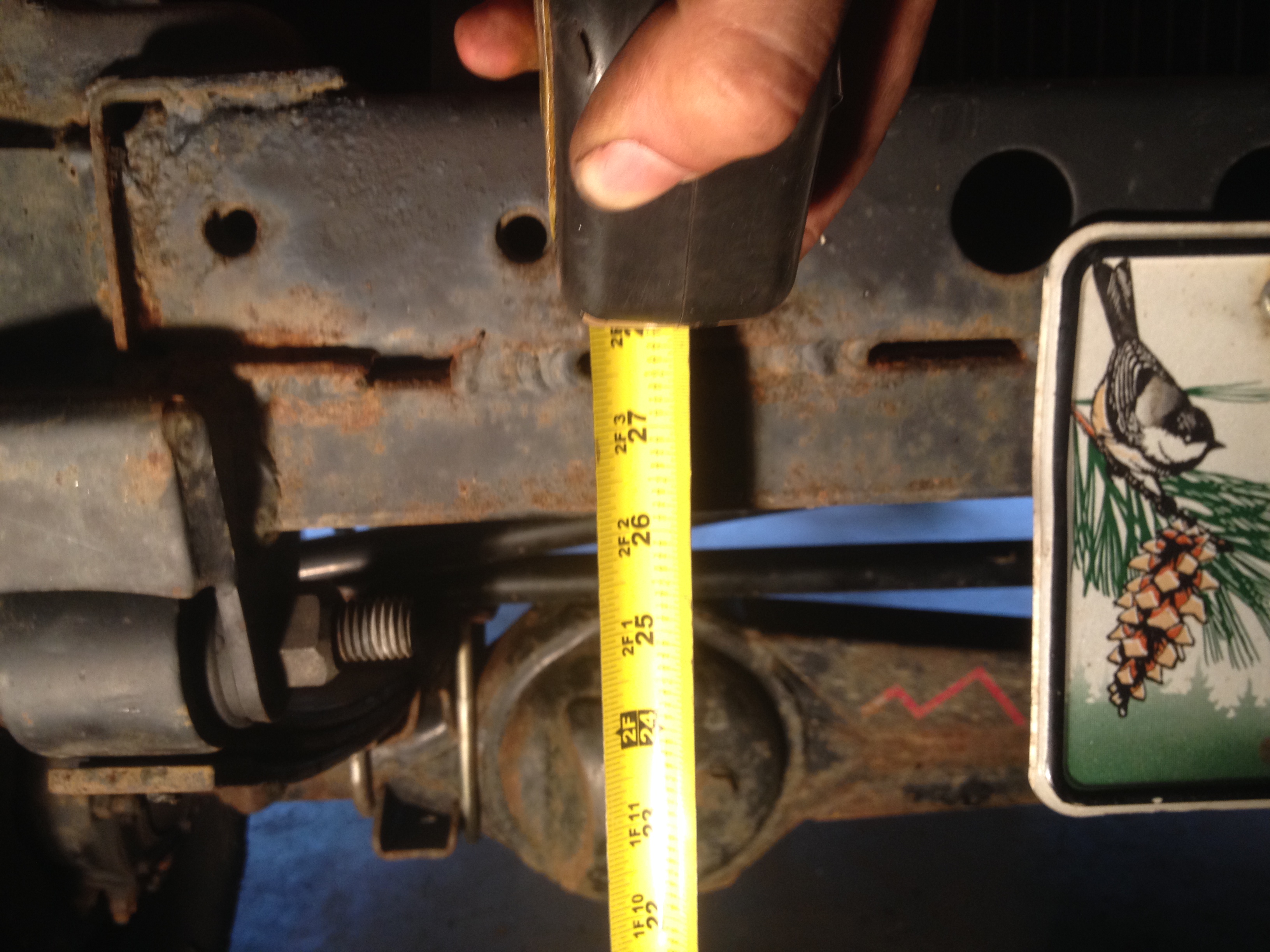

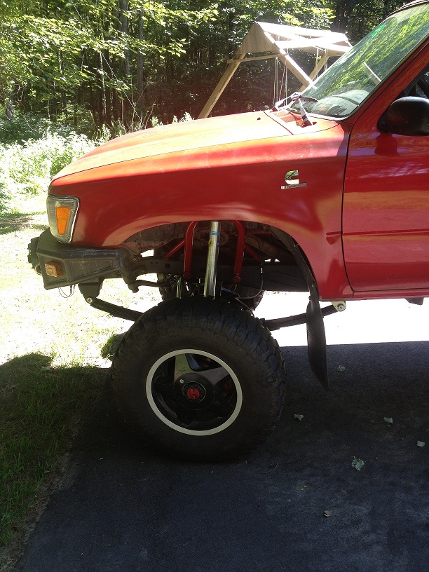

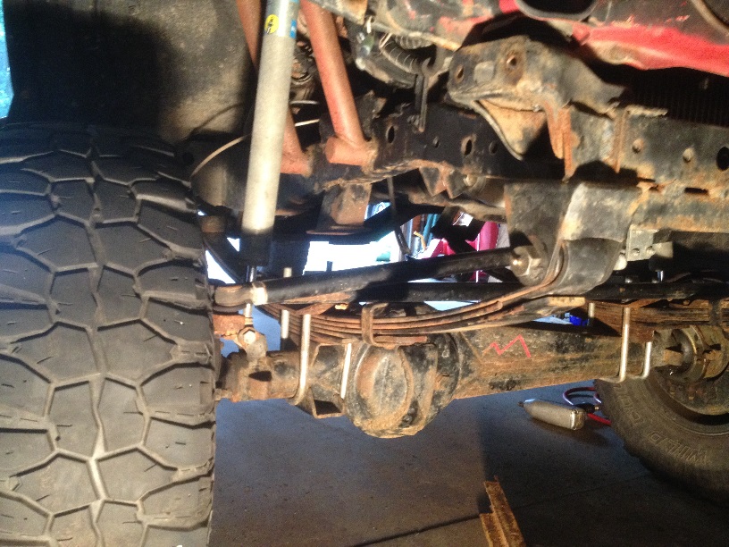

so its been a crazy couple of months. cannot seem to get any time to work on the truck or on anything else for that matter. but heres where im at now. i have removed a leaf from the front and im at 26 ground clearance too the frame i have to be at 25 at most. running out of ideas... heres some pictures.
Attached Thumbnails solid axle swap v ifs lift.-img_0771.jpg   solid axle swap v ifs lift.-img_0772-mod.jpg   solid axle swap v ifs lift.-img_0767new.jpg

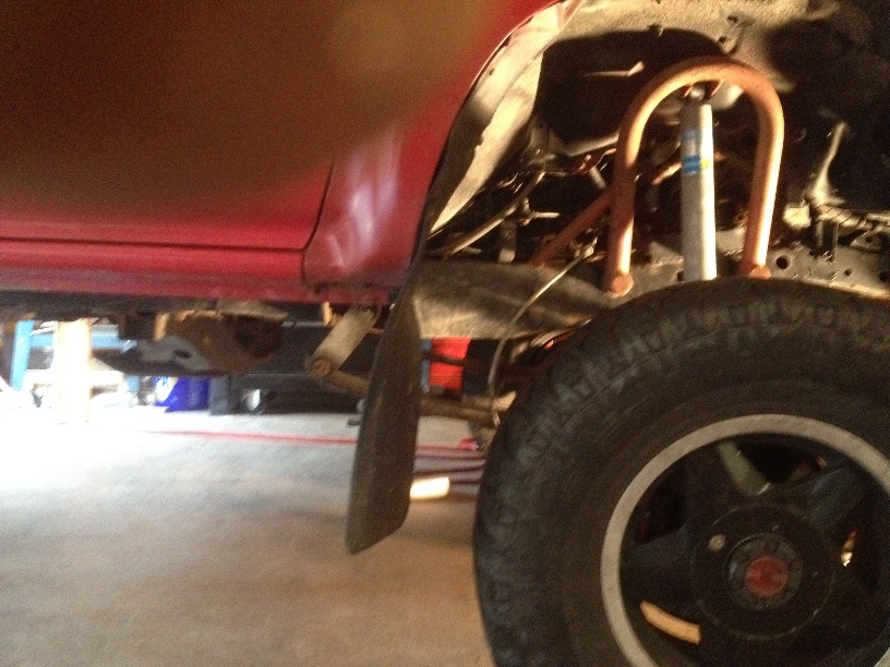

heres a few more
Attached Thumbnails solid axle swap v ifs lift.-img_0768new.jpg   solid axle swap v ifs lift.-img_0773new.jpg
Old Jul 22, 2014 | 03:30 AM

Put some miles on the truck if you haven't. Does the truck have to go thru an inspection? If so load it up with a bunch of sandbags lol.

From: Northfield, Vermont
Get smaller springs?
Weld some metal to the bottom of the hanger to make it be 25"? haha.

unfortunately it does have to go through inspection as it is my daily driver and woods rig. unfortunately here in maine it is supposed to be measured at the frame where the bumper mounts. so where i measured it is a judgement call as is let alone welding something in to make it lower. I think for now im gonna wait till i finish the rust repair work on the bed and put it back on and see exactly where i sit. i also have put about 2000 miles on the truck since the SAS
does any one think that i can remove any more leafs and if so which ones.
like you can see the shackle out front is wicked short as is and i dont really have money for new springs anytime in the near future as im currently a full time student.
