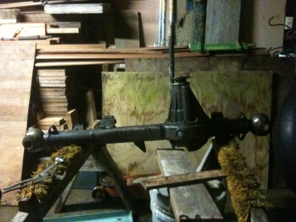

Ok, now here is whats up.. I was given a free solid axle with the 3.4l motor when i bought it and i have not extended my knowledge to axles yet at all but i am going to start on the swap from what i have read and from some friends help.. But i honestly do not even know what axle i have or what it came from and i was wondering if anyone could tell me.. Here is a pic of it
I am very excited to get rid of my ifs and as far as the work i think i can handle it myself, i just kind of needed a kickstart to know even what axle im dealing with here so i know what to buy to match it

It's a Toyota Front Axle. If it has a long brace under it then it's an 84-85. If short, it's older than 83. Doesn't really matter what year. All the aftermarket stuff will work with it.
Good luck with your swap.

Tie rid is bent
79-80 axle if there is no factory truss
81-83 axle will have short truss extending about half way.
84-85 axle truss will extend to DS spring mount.
I have example pix of each in my 'mini FAQ' link in my sig.
Would copy and paste it but it is a paIn to do on my phone..
Edit: hang on to your v6 caliper, combine those with vented LC rotors and you will improve the braking vs the stock SA brakes. As long as your axle is an at least an '81 it is pretty much a direct conversiOn. If you have a 79-80, rotors will be an issue

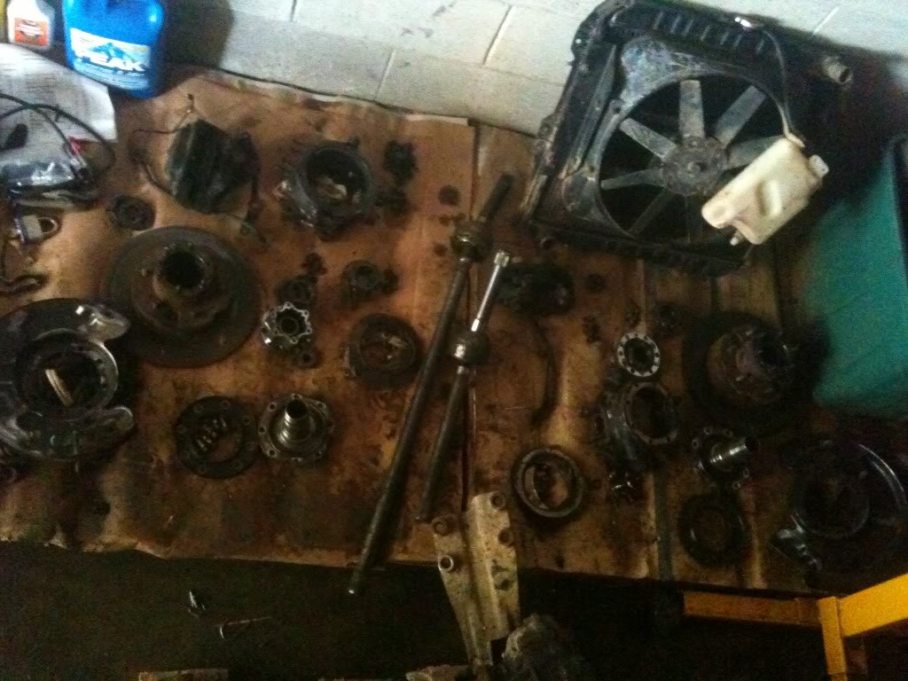

ok so after checking i have an 81-83 axle
Here is a pic of what i got done tonight.. cleaned up a little bit and stripped down.. Ill start cutting and grinding tomorow..

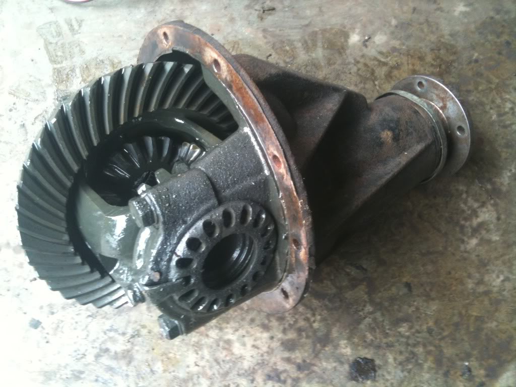

Ok so i have everything all cleaned up and ready to go. Now i just need to decide whether to go with TG's IFS Eliminator or The AllPro SAS Kit.. Does anybody have any suggestions from their experience on which on to go with?
Does anybody know what gears i have? haha or how to tell what they are? because i was planning on running 4.88's up front but that just depends on what this thing came with..
