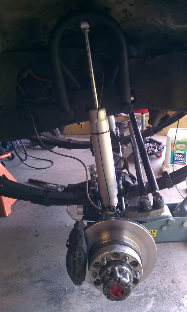

so i just SAS my 87 runner and im trying to get the breaks done but they are not fitting, i was told to do fj60 rotors and ifs calipers v6 but the caliper is hitting on the rotor when i go to bolt it on. what am i doing wrong?

Pics might help, however, I believe you have the rotor on the wrong side of the hub......

The old rotor bolted to the outside of the hub. The 60 rotors will bolt to the inside of the hub.....
