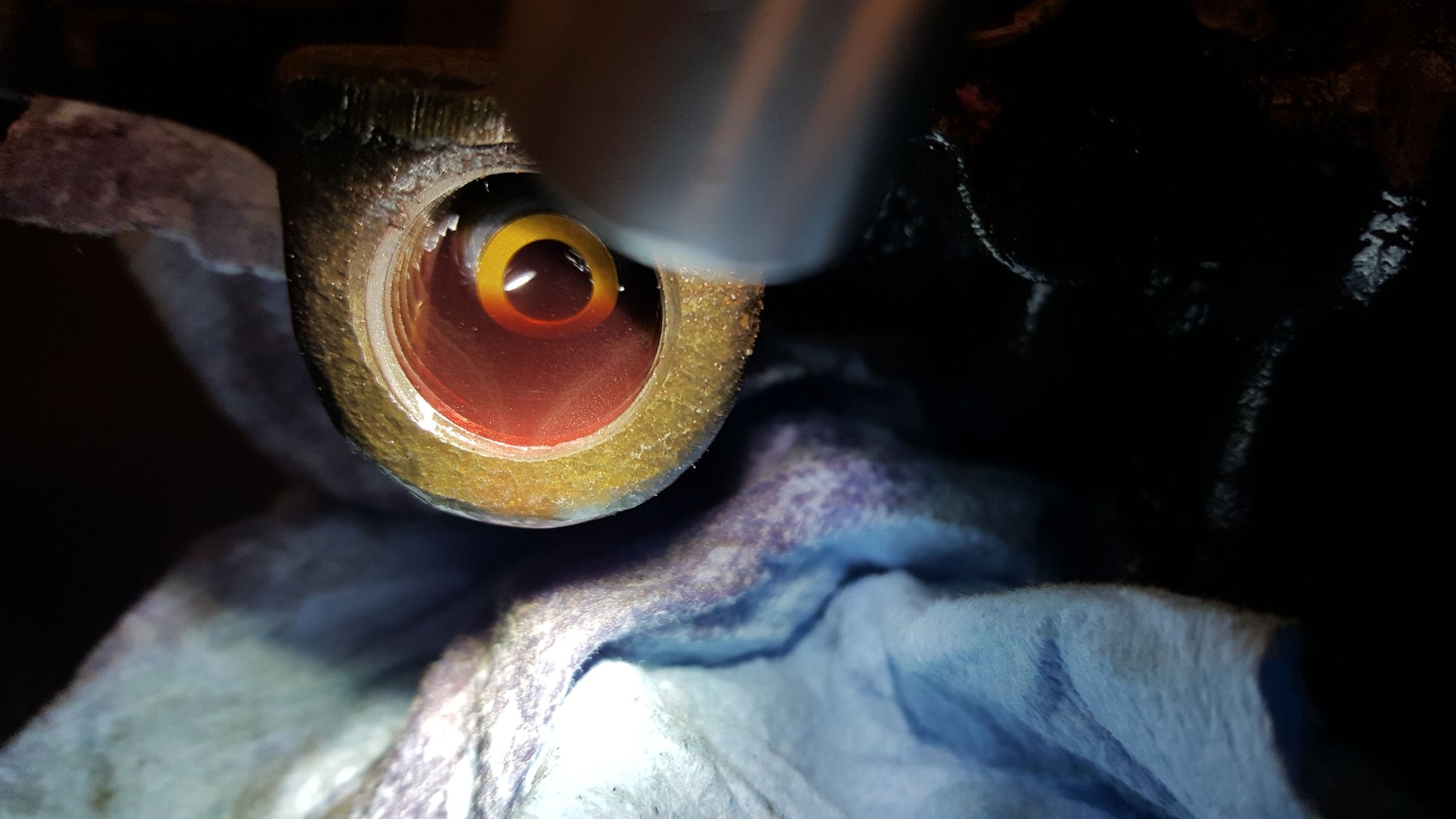

Yesterday I got around to pulling the pump and disassembling. I did find some shimmering pieces of metal in the fluid so I went ahead and replaced the pump, the inline filter, the lines, and this time also swapped in a steering box. It seems that the box had been contaminated with shavings and is killing the pump out as this is where i saw the biggest amount of metal in the fluid. This time I also set the steering stops on the axle to hit just before the limit on the steering box. I hope it takes care of it I will report back results just as soon as I use it.

Makes sense all the pump failures added more metal shavings to the mix
Causing each pump to fail fast
I think and hope your problem will be solved .
although you might look at the option of installing a pressure side filter it will not be cheap

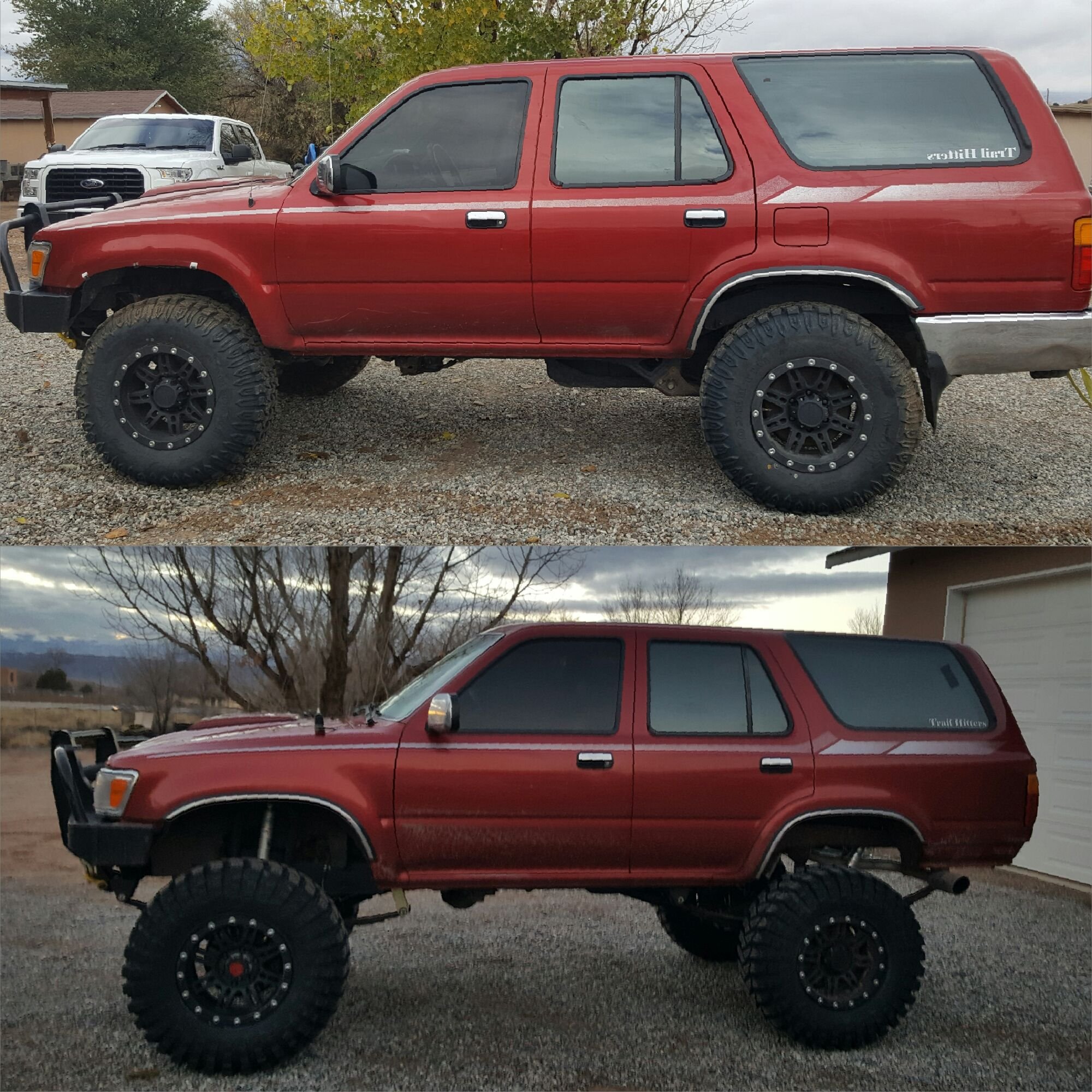

Thanks for the replies guys! Happy to say that I have about 200 miles and 60 miles of snow wheeling even had it in 2.5 - 3 ft of deep stuff and it feels great. No signs of failure. Thanks Zuk for the over on the diff, that harrop locker is the way to go, I had plans on doing the arb but was over budget at the time, now wish i would have even though the detroit locks up well! A little about how I did the SAS. Late Sept 2016 I went for a trail ride, broke the rear ring and pinion so I pulled the rear shaft and started driving down the mountain in front wheel so I popped the front diff too. I had a front axle from an 84 4runner laying around that a friend gave me several years ago. October I sourced all the parts ( Trail gear 4" front and 5" rear kit, new 4:88 gears and install kits and finally the realized i had to rebuild the entire front axle. I found on low range the high pinion diff with 488's and detroit for about what it was gonna cost me for the arb diff and ring/pinion alone so I went that route, next time I hope there really isn't, Ill use you Zuk! All the parts showed up by the end of october, every weekend in November some friends and I were on it and got everything completely done by the first weekend in December and new tires before Janurary! I couldnt be happier with the way it all turned out. Thank you all for your help and insight!!
