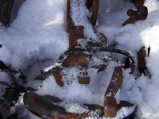

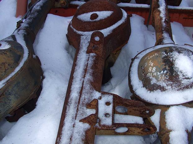

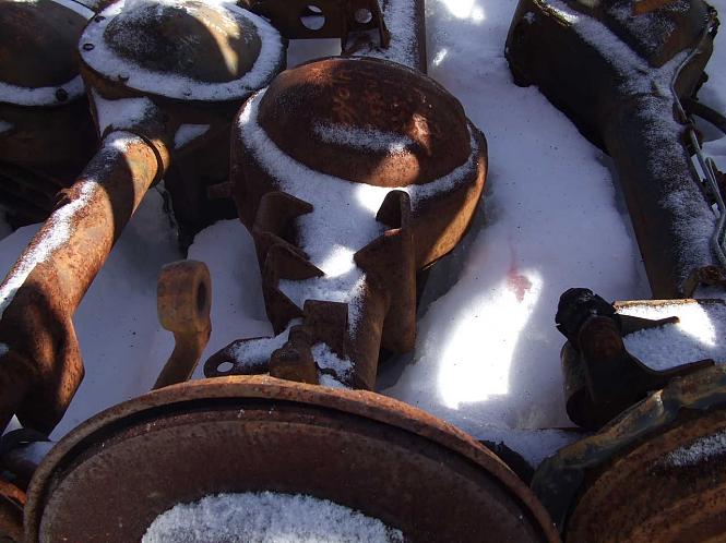

How can I tell what year axle I have?
The yard I'm getting it from claims it's an '85, but is there any solid way of telling for sure?
Here are the pics that they sent to me.
Attached Thumbnails How can I tell what year axle I have?-dscf1512.jpg   How can I tell what year axle I have?-dscf1513.jpg   How can I tell what year axle I have?-dscf1510.jpg

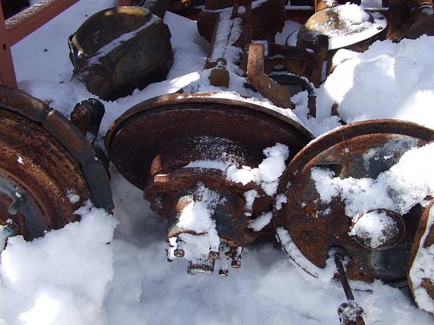

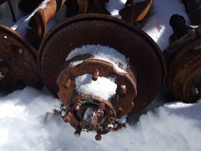

a couple of more pics.
Attached Thumbnails How can I tell what year axle I have?-dscf1511.jpg   How can I tell what year axle I have?-dscf1514.jpg

84-85 has a trussing on the long side of the lower section of axle housing other than that they are the same. Cant tell inthe picture cause of all the snow, hope they dont want much they look all rusted shut gonna need a case of PB blaster to crack it open for a rebuild.

*edit* Dangit Bob you typed the exact same thing as I did, only faster
84-85 axles (the most desirable) have a truss that runs thebottom length of the long side of the housing. Thats the surest way to tell.
I'd like to be able to help ya, but all I see is snow.
Btw, i hope they don't plan on charging you more than $100 for that thing sitting open and exposed like that. You can typically find axles on CL for around 2-400 in MUCH better shape, and complete with the hubs. Those hubs are very expensive and very hard to find. Like i said, unless its really cheap, i wouldn't go for it.

I'm not too worried about the hub assembly or condition of the inerts of the axle because that will all be replaced with new parts. Probably going to use the 27/30 spline longfields so that I can use my IFS manual locking hubs.

Who cares what year that axle is...it is a rusted worthless piece. Pass.

Ya dude that axle is going to end up costing you more than $350 - 500 just to get it up to snuff. Hope you have a good sandblaster. From the looks of it probably only the housing is worh keeping. Maybe.

Sandblasting required. good luck.

Looks like only the housing would be salvageable...and that's after blasting
hope its dirt cheap...
