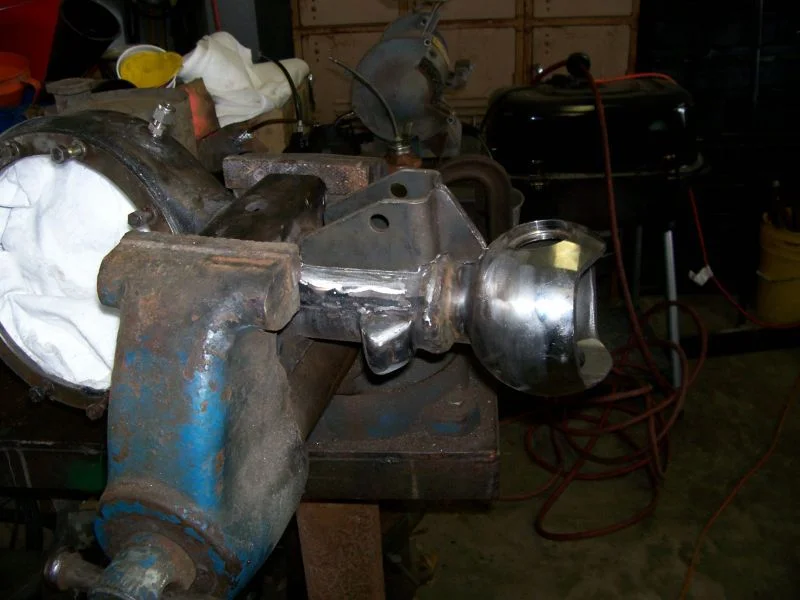

With the help of some friends we installed the Trail Gear 5'' kit with the HD springs up front and 5'' classic rear lift. I also installed 5.29 gears and Detriot lockers front and rear. The only big problems with the kit was the steering box had to be moved forward due to crossover steering and the front drive shaft will not work with the stock front CV style u joint. The front does set a little higher than the rear, but that can be solved with removing some springs from the pack. Just thought I would share so enjoy.

Where did you get the front shock mounts and knuckle gussets?
Old Jul 15, 2008 | 10:16 AM
dirtoyboy's Avatar
Joined: May 2006
Posts: 2,377
From: St. Loser, Misery
Those are trail gear design
Old Jul 15, 2008 | 11:38 AM
John S.'s Avatar
Joined: Sep 2007
Posts: 99
From: Lafayette, La
yep, trail gear
