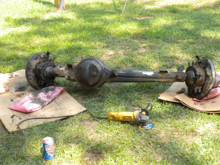

some before pics
here are a few before pics and the axle when i got it.(its from a 1985 of course) cutting all the brackets off and cleaning it up for the truss and high steer.
Attached Thumbnails 87 4runner SAS weekend project-dscn4699.jpg   87 4runner SAS weekend project-dscn4714.jpg   87 4runner SAS weekend project-dscn4928.jpg

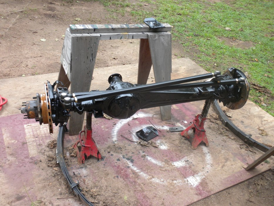

axle pics
axle build pics. trussed up and high steer added, and i put 87 4runner calipers and rotors on. those 85's warp too bad.
5" skyjacker softrides front and rear.
all other stuff for sas is trail gear.
Attached Thumbnails 87 4runner SAS weekend project-dscn4972.jpg   87 4runner SAS weekend project-dscn4992.jpg   87 4runner SAS weekend project-dscn5043.jpg

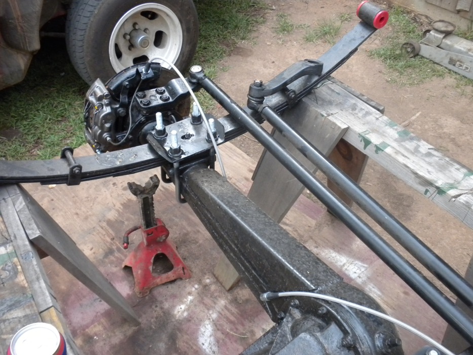

cut everything off, tacked everything on, measuring and measuring again..
shock mounts trimmed and ready to go on. shocks to follow..
Attached Thumbnails 87 4runner SAS weekend project-dscn5188.jpg   87 4runner SAS weekend project-dscn5197.jpg   87 4runner SAS weekend project-dscn5201.jpg

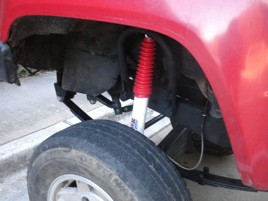

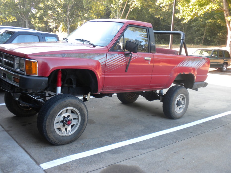

thanks, had some computer problems but got them fixed. here are some of the last pictures. i have tons of pics, but just tried to choose the most descriptive one...rides like a champ, needs tires bad.
Attached Thumbnails 87 4runner SAS weekend project-dscn5265.jpg   87 4runner SAS weekend project-dscn5266.jpg   87 4runner SAS weekend project-dscn5267.jpg

all finished now.. but only one thing whipped my butt... everything was pretty easy and straight forward, and just when you think you are done.. no brakes! replaced everything from the master cylinder to ALL THE BRAKE COMPONENTS...i would never in a million years guessed what was causing the pedal to build up.. then after a few seconds.. to the floor.. i used two professional bleeding systems, one that pumps from the brakes to the reservoir, and one that pumps from reservoir to the brakes,. i was getting plenty of fluid at the bleeders, no air.. but no brakes.. finally figured out it was the front.. note to self..(and to anyone else who does this)
step 1. remove front calipers.
step 2. press brake petal until all 4 pistons have pretty much came out their full stroke
step 3. break open bleed valve, and depress the pads back to push the pistons back so they will fit around rotor.
step 4. reinstall calipers and they will now work.
i am sure someone will think that that is what they would have done first.. but EVERYTHING was new. and i didnt expect this to be an issue. obviously, the reservoir behind the pistons has to be big enough to build up pressure or it bypasses to the bleed screw.
LESSON LEARNED.

Are your bleeder valves on the top of or the bottom of the calipers? Hard to tell from the pictures.
Whats with the mini blocks under the leafs? You only need one on the drivers side to level things out. ( Edit, ment drivers side. )
Otherwise, Looks great! What size tire are you planning on running?

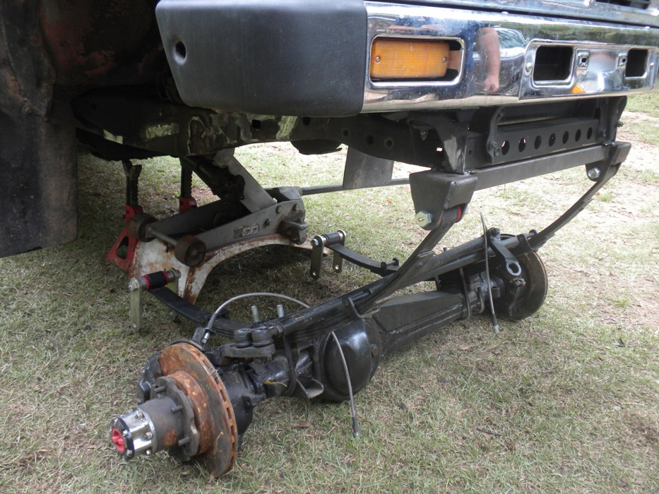

cut out ifs.. auto locking hubs. gotta get rid of this thing..
Whats with the mini blocks under the leafs? You only need one on the pass side to level things out.
they were on the bottom of the calipers..
i only added the one on the driver side.. passenger side had one already.
thanks man.. i plan on a 39.5 but those things are expensive!

just realized what you meant about the small spring pads, some spring manufacturers dont sell left and right springs, so you have to put a 3/8 pad on the drivers side to level them out. if they were factory springs, you are right, only the passenger side gets it..

Tires are expensive. Haha. Going to run the stock gears?
If I read that right, you have the calipers on the wrong side, thats why you were having such a hard time bleeding them. The bleeder valves go on top, air goes up.
Close... the drive side is the low one (your right there). So you only need 1 pad, under the drivers side to level them out. Looks like you have 2 on the drivers side and one on the passenger... If they were factory spring, neither side you get the pad because drivers side spring would be 3/8 taller.
For the superlift springs, you should have 1 pad under the drivers side, and thats it.

Yes you are correct... Had the calipers swapped, but if you do that lol, I know my four steps will bleed them fine lol
As for the spring perch pads, since there was one on the passenger side.. I had to add one to the drivers side. Drivers side was dramatically lower. My springs were soft ride 5" and they were the same. Leveled up nice. Almost done with the double u joint driveshaft. I don't do hard wheeling so it should be fine. Only hunting and driving to workl lol

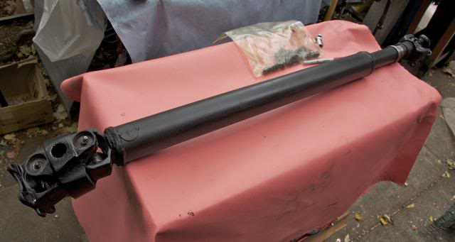

The roar in the rear is from output pinion to drive shaft angles.....good luck.

Nope... Found u- joint bad. Angle is perfect. I couldn't tell because I only checked axle end u joint.. Upper one was D stroyed... Don't see how I missed it but man was I glad it was a u joint. Thanks though!
