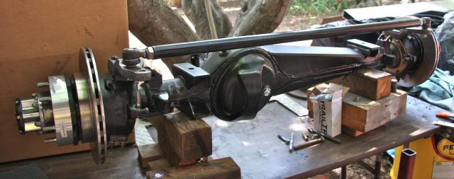

Took me 10 years to finally do my swap. It started with this..........
This was 4 years ago and at that point I had had it 6.
