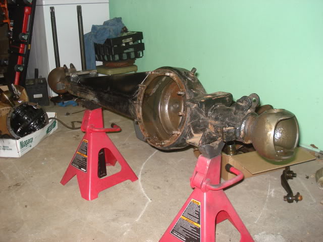

The 83 straight front axle was also found on craigslist. The diff is broken but otherwise seems to be in fair shape. Manual hubs seem to be functional as far as I can tell.

I decided to start with the rear. I striped down rear axel to the shell so it will be easier to handle while lining up spring mounts. Unless anyone knows how to determine where to weld the mounts. Please let me know because that would help me a lot!!! I have the stock axle out and will start cutting the original mounts tomorrow. Once I have the springs mounted I will mod the axle housing to accept the e-Locker 3rd member.
More on this as the project progresses. Here are some pictures for now.
