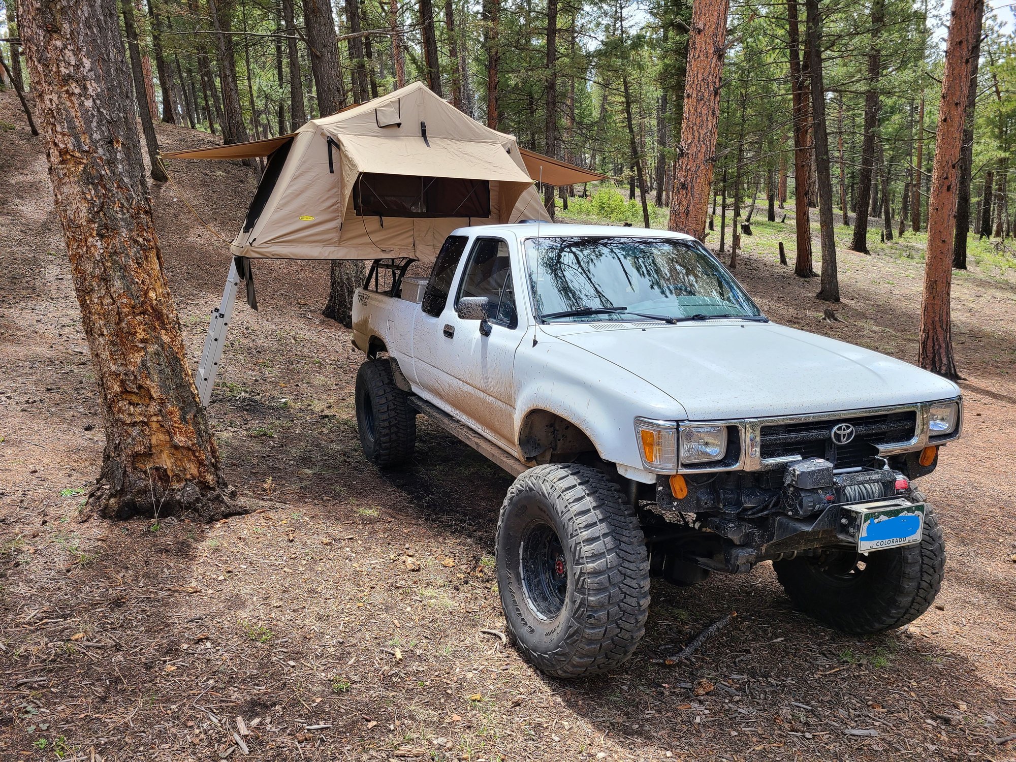

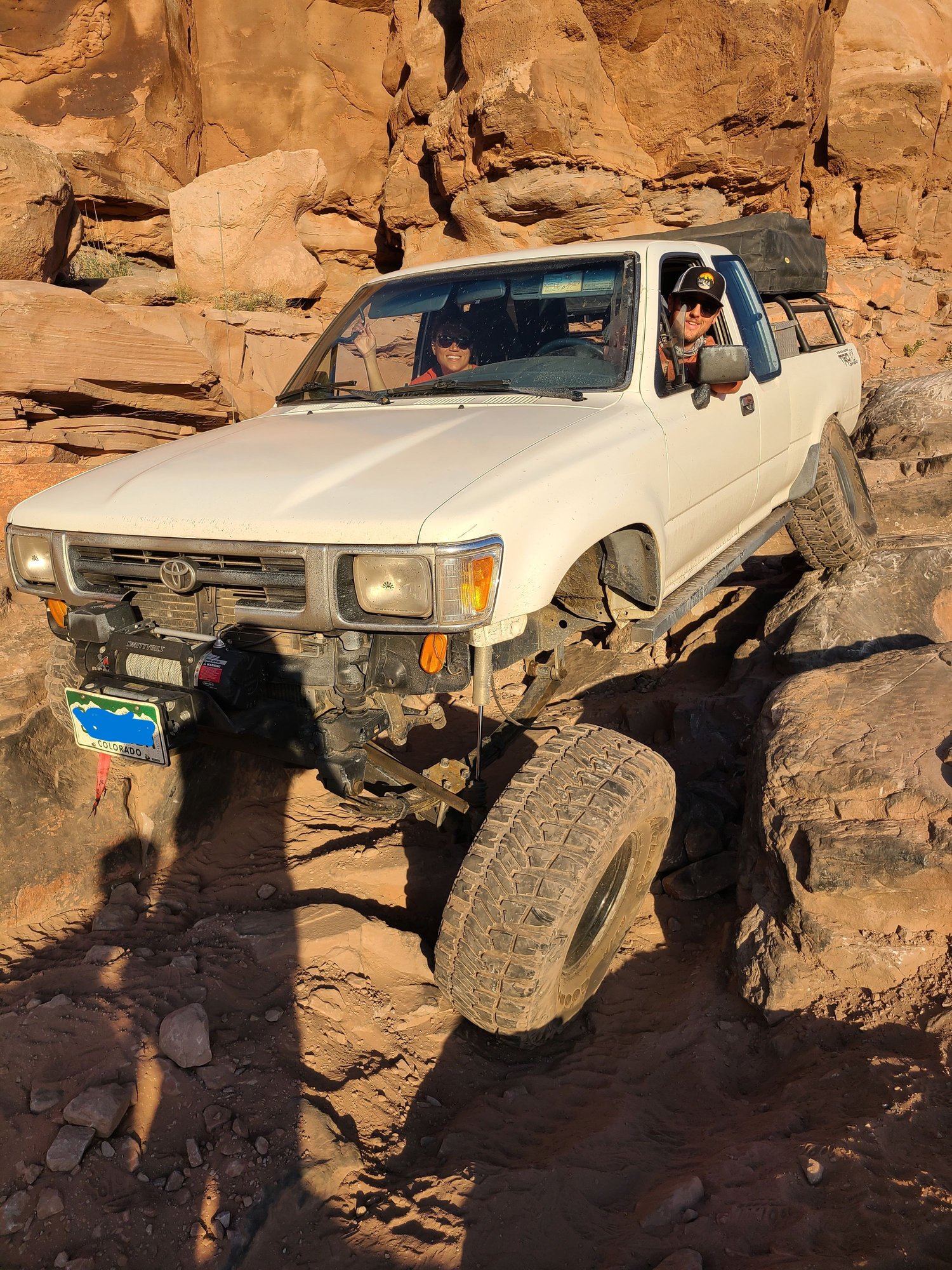

1994 Toyota SR5 SAS
This is my 94 rockcrawler. I've had it for a few years now. V6 manual. Solid axle swap from an 84' with aftermarket top gusset. Differential lockers with High Pinion Toyota E-locker front (from an FJ80) and a TRD E-locker rear (from a 1st gen Tacoma) 4.88 gears w/dual transfer cases, 2.28 & 4.7 ratios (Marlin Crawler) 4" suspension lift on 35-12.5R15 tires

Geez Blueprint....Nobody has responded in months to your post. Cool that you took it thru the Golden Spike. Did you do the Double Whammy? The wheelbase should have made it look easy. Sounds like you got all the right upgrades👍👍👍👍👍
oops....just saw that you sold it a couple weeks ago. Sorry to hear that. Somebody got a hell of a good deal for $9794.
