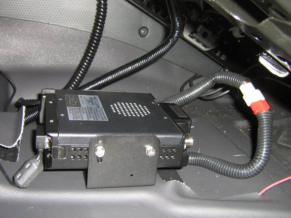

Step 1- Find a good mounting location: After inspecting the best possible location to mount the radio we found under the drivers seat was going to be ideal spot, Remove plastic guards to access the 2 rear bolts them remove the 4 seat bolts with a 14mm socket, After doing so Tilt the chair back towards the rear of the FJ so that the floor board is now exposed.
Step 2- Removal: Remove all drivers side running board pieces along the edge of the door, these pieces have no screws to remove like the Tacoma's and will just pull straight up DO NOT pull to hard or you WILL break the plastic clips, Now remove the Kick Panel first remove the plastic foot rest by pulling it straight out, again no screws just clips in, Now you will have access to the plastic screw holding the Kick panel unscrew and remove kick panel. Now you can begin running wires.
Step 3- Wiring: Icom includes a 15ft long 10ga Pos/Neg power cable with inline fuses on Pos and Neg and recommends running radio direct to the battery. First use any tool to fish the end of the power wires under the carpet and pop out where the foot vents are under the seat, Leave enough slack in the wires after pulling connector through floor, Now run the wires along the trim with the factory wire harness towards the firewall, Now with a razor blade cut an X in the Firewall grommet where you will be running the wires through. Now use any tool that works best for you to fish the wires through the firewall, Tape wires with duct tape to fishing tool and pull straight through grommet, While doing so make sure no wires are getting hung up inside that could potentially be yanked out on accident. Proceed with running the Pos/Neg to the battery now and use proper terminal connectors, Electrical tape any open connection and wrap wires with a loom that are near sharp edges.

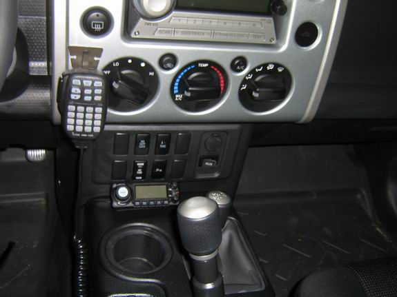

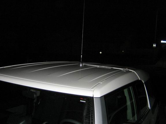

Step 4- Almost Done: Now to mount Antenna and Face Plate, We decided to go with a Mag mount antenna which isn't the best idea for our application but we didn't want to drill through the roof on a brand new vehicle, We painted the antenna wire with Toyota matching white paint to make the wire not such an eye sore on the roof, Run the wire along the top of the roof and come down the Driver side rear door seal down towards the running boards, Run wire along running board and repeat fishing process under carpet to the radio. Now to run the detachable face plate it comes with 10ft wire kit, Run wire from the radio along the inside of the center console and pop out in front of the 1st cup holder, We used Industrial grade 3m velcro for the face plate to be mounted at the angle and spot we wanted, It works great and is very solid with the 3m tape. Done now test everything out and button it all back up and learn to use the radio.
