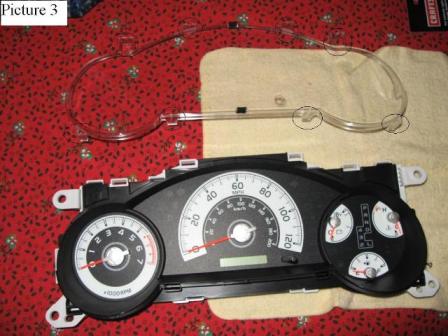

Step 2: Gauge Cluster Disassembly

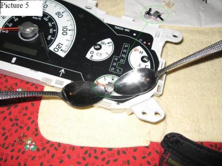

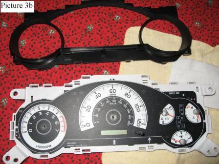

Place the gauge cluster face down on the towel to keep from scratching the clear plastic face. Locate the two (2) Phillips head screws on the back, remove bag and label (See Picture 1). Now using the flat head screwdriver, unclip the lock tabs holding the back cover on (See Picture 2). Do the same process for removing the clear lens and inner bezel (See Pictures 3 and 3b). Note needle placement in picture 4, mark locations lightly with a lead pencil for re-install later. Removing the needles can be easily done with two (2) spoons. Slide the spoons under the needle and slowly push the spoons down till the needle comes off (See Picture 5). Remove all the needles, bag and label. With the needles out of the way you can now remove the gauge face (See Picture 6). Here is where you need to be careful. You must slowly remove the LCD screen from the circuit board; the LCD screen is not soldered in, so you can remove it with “ease”. Once the LCD screen is removed bag and label it. You can now remove the green circuit board from the white casing (See Picture 7).

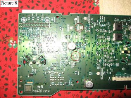

The LED swap is going to be explained from left to right on the circuit board. The LED’s to be removed on the left side are circled in picture 8. I’m only replacing the white LED’s, the turn signal, door ajar, and the seat belt LED. If you look close you will see a letter next to each LED on the circuit board, this corresponds to the color of that LED.

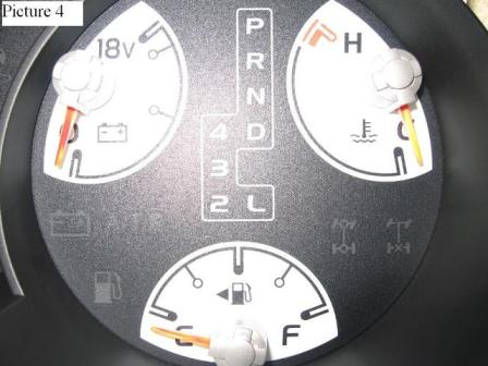

First, remove the three (3) white LED’s from the “tachometer” these are labeled LED4, LED5, and LED7. Install the new LED’s in those locations, the arrows on the circuit board show which way to install them. Next, remove LED29 “Turn-L (G)”, LED2 “D-Belt (R)” and LED28 “Door (R)”. You will use the two (2) red LED’s from the “Door Ajar” and “D-belt” later on the AC unit, so bag and label those (See Picture 8).

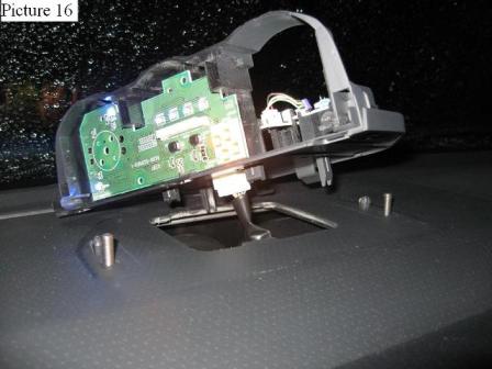

After installing these LED’s take the circuit board back into the FJ, and test the LED’s by turning the headlights on with the door open. LED’s 2,4,5,7, and 28 should be lit at this time, test the left blinker also. If all the LED’s work move to step 4.

After installing these LED’s take the circuit board back into the FJ, and test the LED’s by turning the headlights on with the door open. LED’s 6,9,11 and 22 should be lit at this time, also test right blinker and active-trac. If all the LED’s work move to step 5.

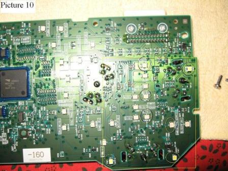

Step 5: Soldering LED’s (Right)
The LED’s to be removed from the right are circled in picture 10. I’m only replacing the white LED’s, Park, Drive, Low, and 4WD.
First, remove the white LED’s labeled LED8, LED10, and LED21. Install the new LED’s in those locations, the arrows on the circuit board show which way to install them. Next, remove LED13 “P (G)”, LED15 “D (G)”, LED19 “L (G)”, and LED45 “4WD (G)” (See Picture 10).
After installing these LED’s take the circuit board back into the FJ, and test the LED’s by turning the headlights on with the door open. LED’s 8, 10, 21 and 13 should be lit at this time, also test drive, low, and 4WD. If all the LED’s work move to step 6.

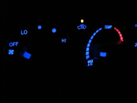

Step 7: AC Control Disassembly
Place the AC control unit face down on the towel to keep from scratching the plastic face. Locate the Phillips head screws on the back, remove bag and label See Picture 11). Now using the flat head screwdriver, unclip the lock tabs holding the back cover on (See Picture 11). Remove the ribbon cable where necessary. Then remove circuit board from black AC casing (See Picture 12).
Step 8: Soldering LED’s (AC unit)
Remove LED’s from left to right on the AC circuit board (See Picture 12). Starting with LED313, LED314, LED310, LED311, and LED312. After installing these LED’s take the circuit board back into the FJ, and test the LED’s by turning the headlights on with the door open. Now remove LED316, LED309, LED308, LED319, LED318, and LED305. Install the new LED’s and test. Next, locate the two (2) red LED’s from step 3, install those in LED306 and LED307 locations. Test. Remove LED315, LED301, LED302, LED303, and LED304. Replace the LED’s with the new ones. Test. If the AC unit passed go to step 9.
Step 9: AC Control Re-assembly
Reverse of the disassembly process. Test the AC control unit after fully assembly. Now is the time to put the dash fully back together and move to step 10.

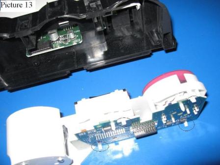

Step 10: Compass/Outside Temperature/Inclinometer Unit Disassembly
First, remove the bezel around the CTI unit. Next, pull the white casing out of the black housing, there may be Phillips head screw or two on the back side holding it in. You will see a small black piece of plastic that looks like a film, bag and label for re-install later. Then unclip the circuit board from the white case (See Picture 13). Slowly pull the circuit board away from the white casing, be careful when doing this because the LCD screen is snug in the board, take your time it will come out. Move to step 11.
Step 11: Compass/Outside Temperature/Inclinometer Soldering LED’s
The LED swap is going to be explained from left to right on the CTI circuit board. The LED’s to be removed are circled in picture 14. These LED’s are different from the other LED’s, these use four (4) legs, but the LED’s you are replacing them with will work. So, all this means is it’s just going to take a little more time unsoldering and re-soldering them. Remove the CTI LED’s starting with LED100, LED101, LED104, LED105, LED106, LED107, LED102, LED103, LED108, and LED109. After installing these LED’s take the CTI circuit board back into the FJ, and test the LED’s by turning the headlights on with the door open. All the CTI LED’s should light up (See Picture 15). If you are wondering why the picture shows blue and yellow LED’s, I wasn’t finished soldering, I test after every completed circuit soldered (See Picture 16). If all the LED’s work move to step 12.

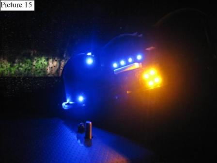

Step 13: Enjoyment
Enjoy your newly modded FJ dash!!! Thanks for using my DIY!!
