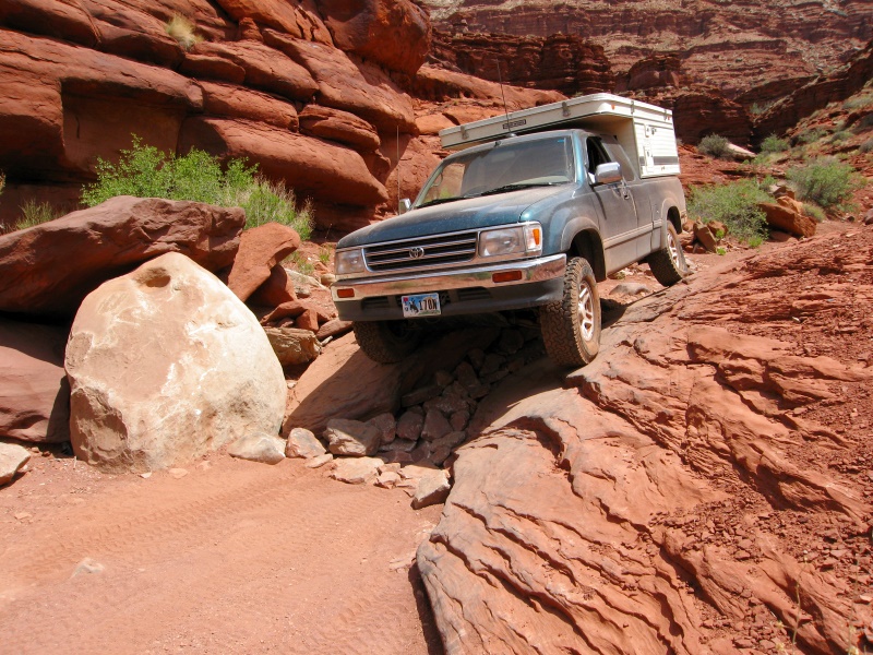

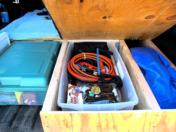

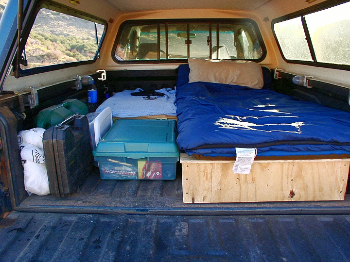

A few years ago, I built a sleeping and storage deck in the bed of the truck for camping trips and long trips way from home -
That was an easy & cheap solution for having a place to camp out of the weather and off the ground. But it was cramped and cold. I got tired of feeling like I was sleeping in a coffin, not being able to get dressed in the mornings standing up and cooking outside on the tailgate when the weather was crappy.

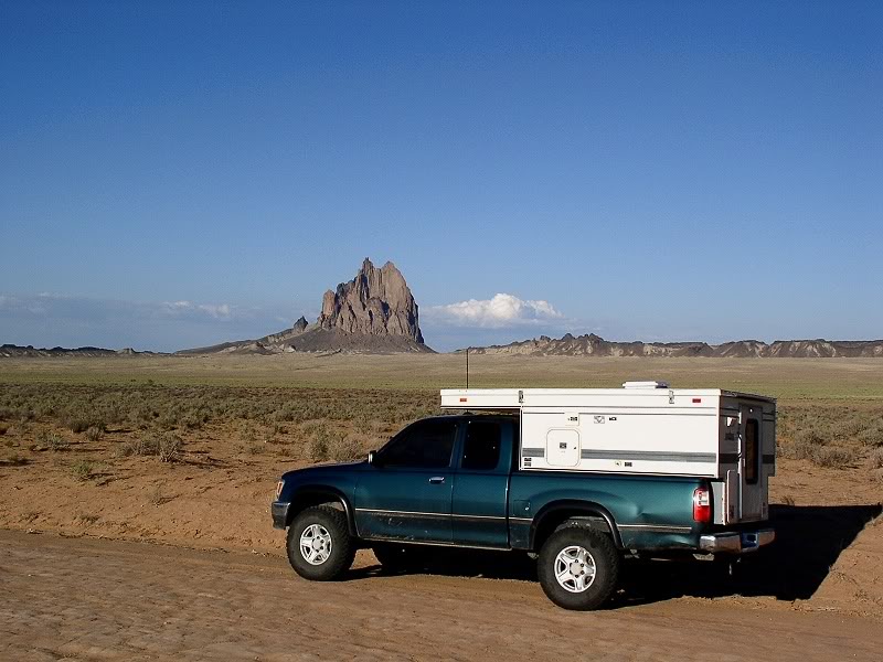

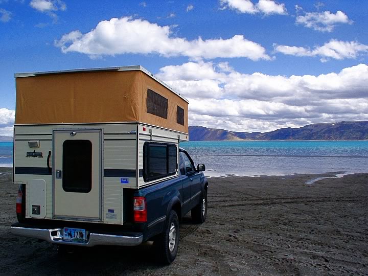

So I pulled out the deck, took off the topper and replaced them with a Four Wheel Camper. The camper is light at around 700lbs., fits neatly to the side rails on the bed and has a legendary reputation with Turtle Expeditions who put a Four Wheel Camper (FWC) on a Ford and drove across Siberia. It is incredibly durable and can tolerate being bounced around off-road, unlike most slide-in campers. The camper is low profile when travelling and pops up in camp for a warm and comfortable place to cook and kick back at the end of the day.
My FWC is equipped with a queen size bed, 16,000 BTU heater, 2 burner stove, 12 gallon water tank, sink and fridge. I've had it in downpours with no leaks, high winds and it stayed up fine, on trails all over the Moab area, Death Valley, Colorado mountain passes and forgotten 2 tracks in Montana. I have no complaints.

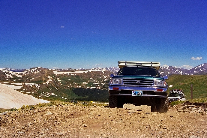

Leadville, Colorado -

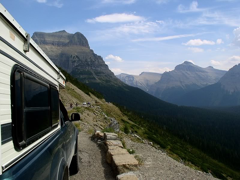

Montana -
Moab, Utah -
Bear Lake, Idaho -

Shiprock, New Mexico -
Moab, Utah -
