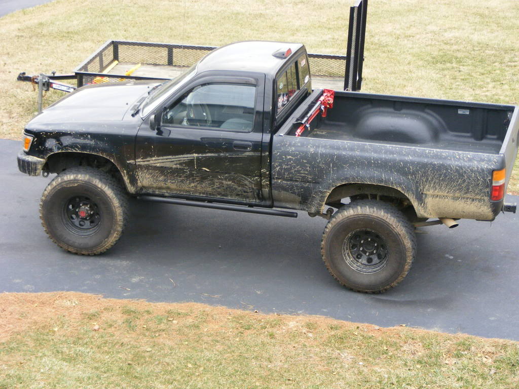

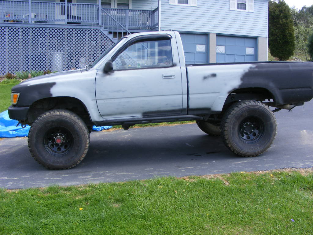

No. Dont run a 3in spacer. I ran 1.5in BJ spacers, and cranked my torsion bars to lift teh truck 1.5in. When I locked the hubs in, teh CVs where at such angle they would bind in the hub and cause the truck to hop, then they snapped. Run a 1.5in BJ spacer, 4crawler.com is a good guy to get them from, and run a 2in AAL, or 2in longer shackle. I ran this and cleared 33 12.50s on 15x8s with 3.75in back spacing

prety level. If your torsion bars are cranked up all the way and its still raked, you got lift springs or shackels or a block out back. I just got some 2in lift shocks. go to topguncustomz.com and you can look at different lift height shocks

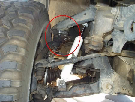

Because that would be extremely dangerous. Just venturing a guess but you probably don't undstand exactly how the spacers lift the truck. Here's a picture.
Aside from the fact that the truck wouldn't be alignable, that would put way to much stress on the bolts that hold it all together. First bump or turn, let alone putting the weight of the truck on it, would snap the bolts and drop the truck to the ground.

Now your reading 3" lift. The BJ spacers are only 1.5" thick. Giving you 1.5" of lift in the front. Now if you crank the torsion bars and add the BJ spacers then you will receive a total of 3" in the front. Always remember that cranking the torsion bars affects the ride quality. So only adjust them alittle at a time. Making sure your satisfied with the ride.
