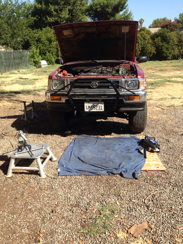

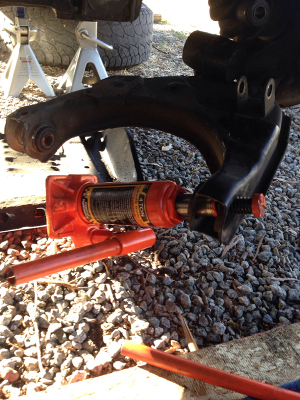

My new favorite thing to fix
Attached Thumbnails Control Arm Bushings, Need Advice-image-1649665425.jpg   Control Arm Bushings, Need Advice-image-59959973.jpg   Control Arm Bushings, Need Advice-image-1066950929.jpg   Control Arm Bushings, Need Advice-image-2183966470.jpg
