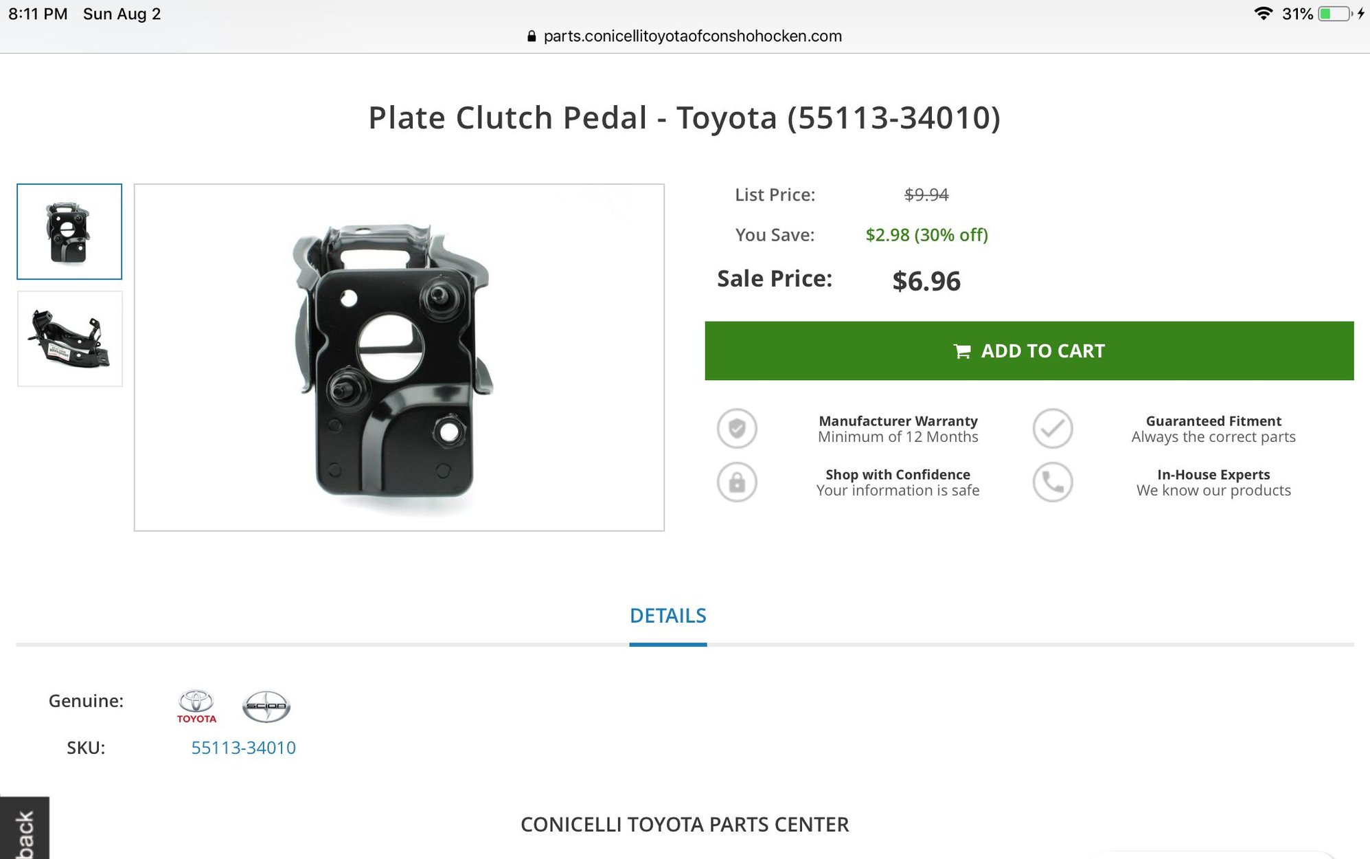

Unfortunately not a totally uncommon problem. The firewall Metal is thin and the repeated pressure from depressing the clutch pedal takes a toll over time and weakens the metal.
Toyota recognized this and used to sell a plate to reinforce the area.
I don’t think it’s available any longer but I believe it was part #55113-34010

At least the pic is a good template to go off of. This is probably something all t100s will need eventually

Who knows.......maybe still available.
Best to confirm this is the bracket to reinforce the firewall.
Give these guys a call as they have been able to get me parts that no other dealer could.
Conicelli Toyota is in PA and they have a very competitive online parts business.
The guys in the parts department (Landon & Derek) are always very helpful.
