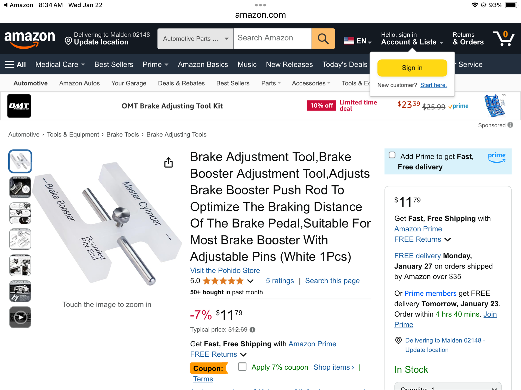

If your booster pin is 1/8” away from contacting the plunger in the master that could be the problem right there. I recently messed around with mine, never felt right, so i got a cheap tool from Amazon for this purpose. It measures the depth to contact the plunger in the master, then translates that to the amount the pin should stick out of the booster. Previous owner’s “mechanic” replaced the booster and master. Could be a mismatch in sone way. I doubt the quality of work of anything that was done to this rig. On my truck for some reason, i find this setup feels best when there is actually some preload to the master. As long as the brakes don’t drag after driving a few miles, it should be ok.

I know the tool but I still appreciate it. The distance should not have caused this problem out of no where. The brakes worked fine with the new master installed so the distance of the pin was fine. It's not going to slowly change could it? I just got it closer to the mc which I felt improvement in the pedal movement before the pin reached the mc. It was maybe I'm not sure 3/4 inch play in pedal before yo0u could feel it meet the mc. Now it feels more like 1/4 inch. I don't know how that could be the issue since brakes worked in the past with a further distance. Is it possible the booster can have a air leak? Like a seal or something I can't see inside around the back of this thing because it's shape. And i have no knowledge of boosters and trouble signs.
