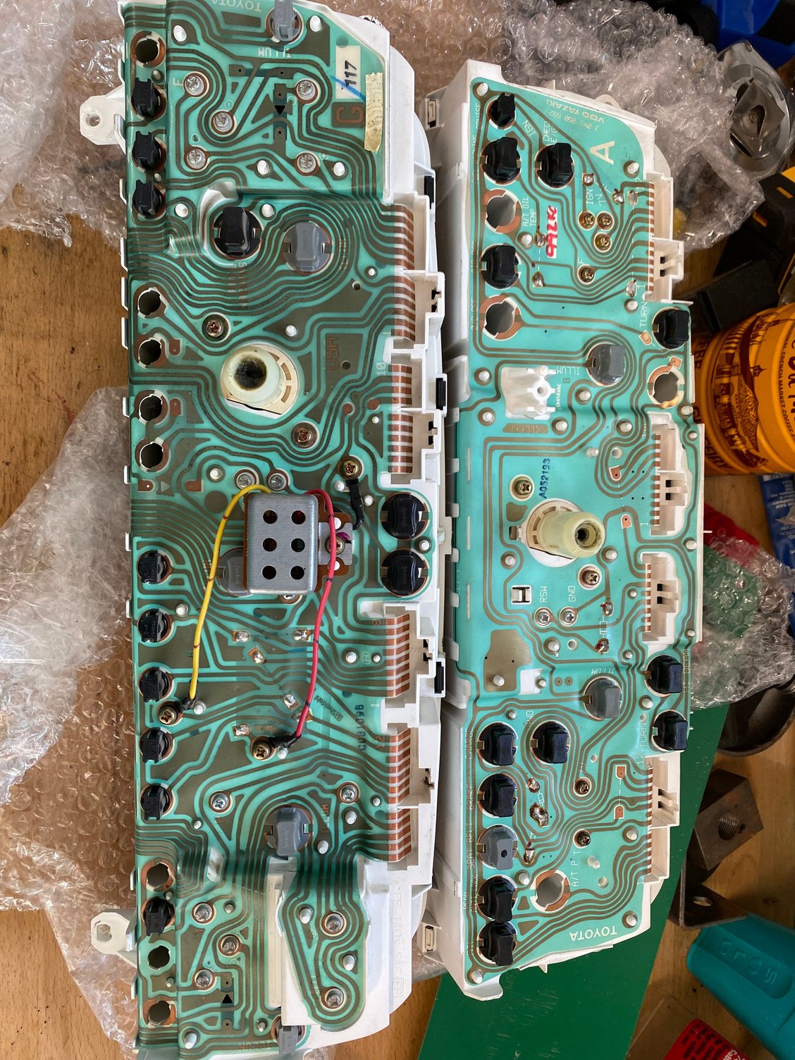

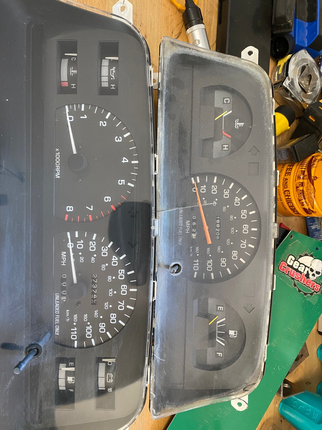

Below is comparison of the original cluster with no tach and the new/used cluster with a tach.
note: everything works with the new cluster but it shows 3000RPM when the timing light shows 1500RPMs
i know there is a blue potentiometer that appears to have a Phillips screw and I thought I read u could adjust the rpm this way but to access it you would have to take the rpm faceplate off so not sure how am I suppose to adjust this tach so it’s correct?

Figured it out… sorta
So I read somewhere that I adjust that potentiometer to 44.9k ohms resistance when measuring on the back side of the tach.
well when u turn as far as u can it’s 43k at the most and when we tested it was 4000 rpm right from the get go.
then I was like, it was at 33k ohms and rpm was 3000 and then 43k it’s was 4000 and with my timing light I can see it’s actual 1600rpm so change the password ohms to around 18k and it should read about right.
bam! Worked like a charm
