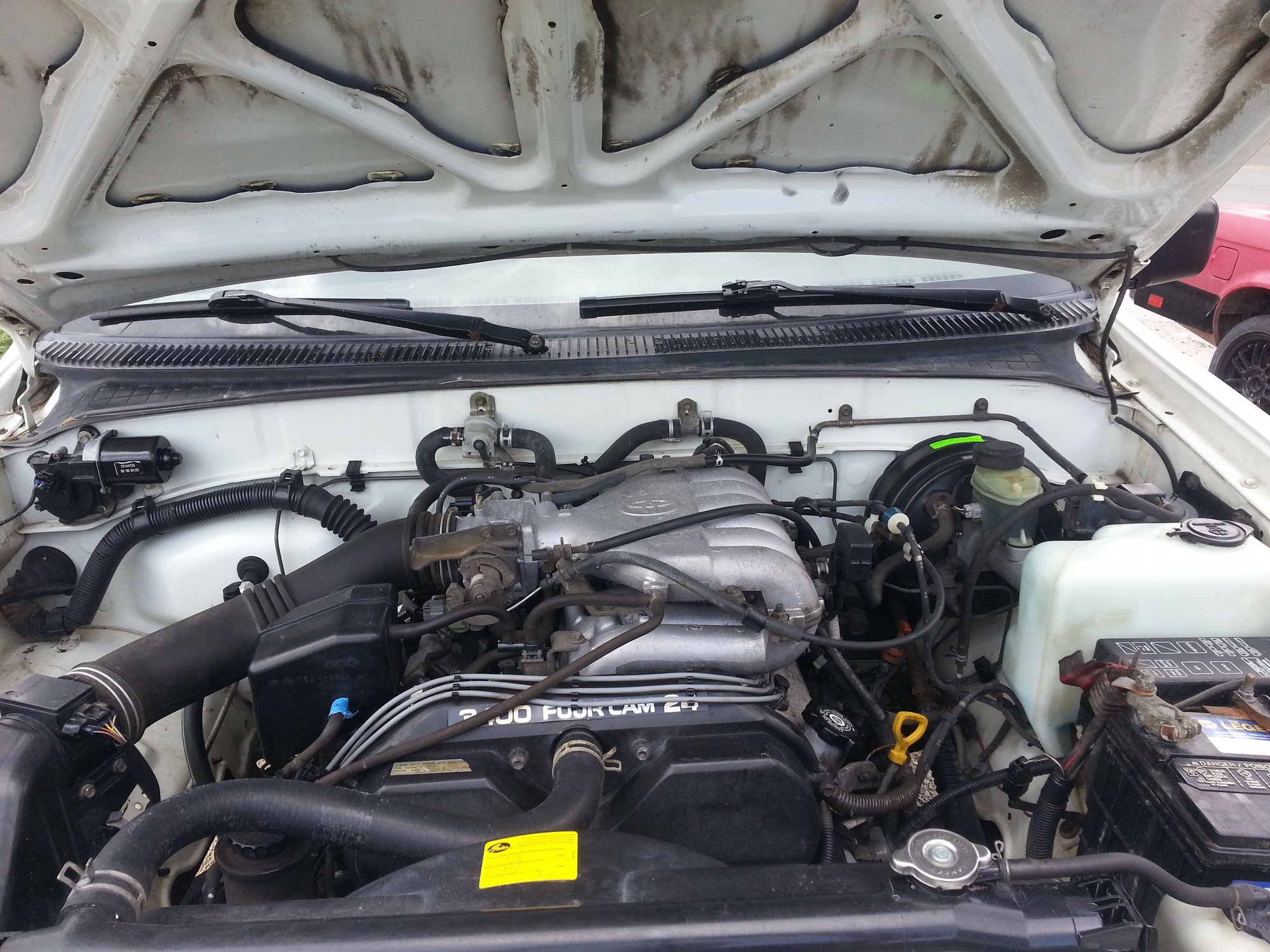

It sounds like you have a clean T100 with the typical mile and age-related maintenance problems. The 5VZ-FE is a great engine.
The engine bay looks clean!

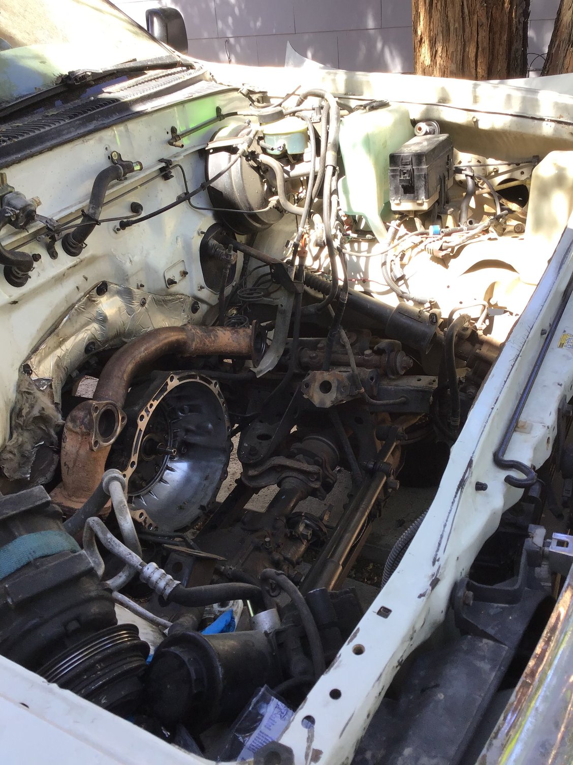

So my head gasket went out and was sending exhaust through my coolant reservoir. I pulled a used engine out of an 01 4Runner and I’m in the middle of swapping the oil pan, intake, alternator, and a couple other bits. Can I use the 4Runner dipstick with my oil pan?

New motor ready to go.
Almost
She’s in
And today she finally started and ran good the wire broke off for the temp gauge so I have to fix that and I have to get some tranny fluid before I can move anywhere.
and the exhaust is fubar.... I had another thread were I swapped the newer 2001 style manifold because my passenger side was cracked in half, but the pipe I welded is to long and too angled to fit the muffler and to tightened all the nuts all the way down. I don’t have a welder at home so I’m gonna have to find time to do it at work, and chop the weld I did and refit it with everything bolted together this time
