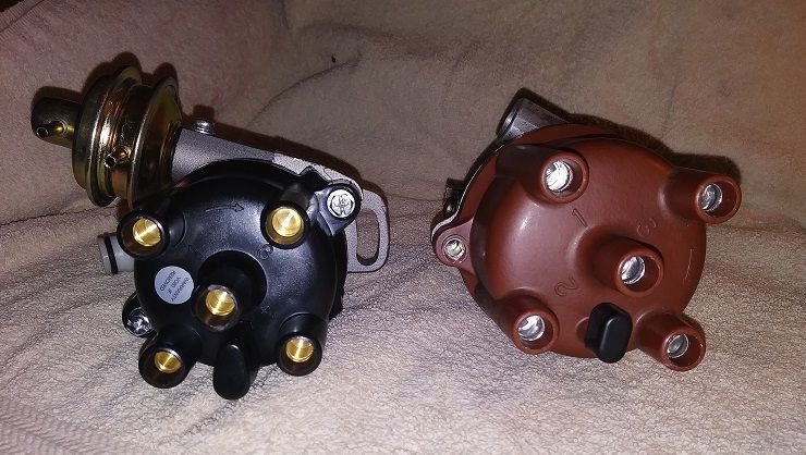

I think you need a 22R distributor also. Beware buying 'new' or refurb as they are NOT matching OEM, smaller body which means rotor/cap that do match OEM do not fit. I have not found any rotor or cap info that would fit. I purchased 4 distributors this year from 4 different places (2 from Rockauto, 1 from OReilly, 1 from Advance Auto and 1 off Amazon). Also the wiring is routed differently. The vacuum advance ports point in opposite direction from OEM too. Still works but need longer lines. Since going weber don't know if you'll use advance as I'm still using Aisan carb.
Aftermarket on left.
OEM on right
OEM on right
