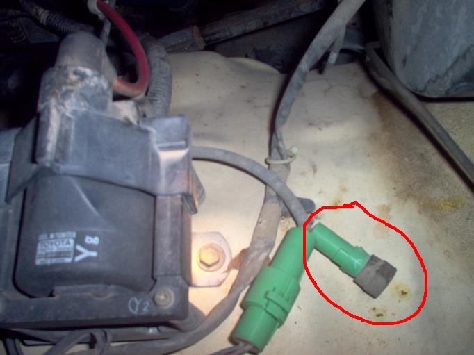

I have an 85 pickup with a 22r in it and I just bought a Sunpro tach today. I have everything wired up exept for the green wire that is supposed to connect to the coil. I can't figure out were i need to connect it. Any thoughts? Thanks

you connect the green wire to the negative of the coil... below is two pics of the two different coils on 22r(e) and where you need to connect it too
Attached Thumbnails New Tach problems-tach-1.jpg   New Tach problems-tach-2.jpg

Thank you very much deserttoy. I hooked it up today but it still isnt working so im guessing my tach is bad.
