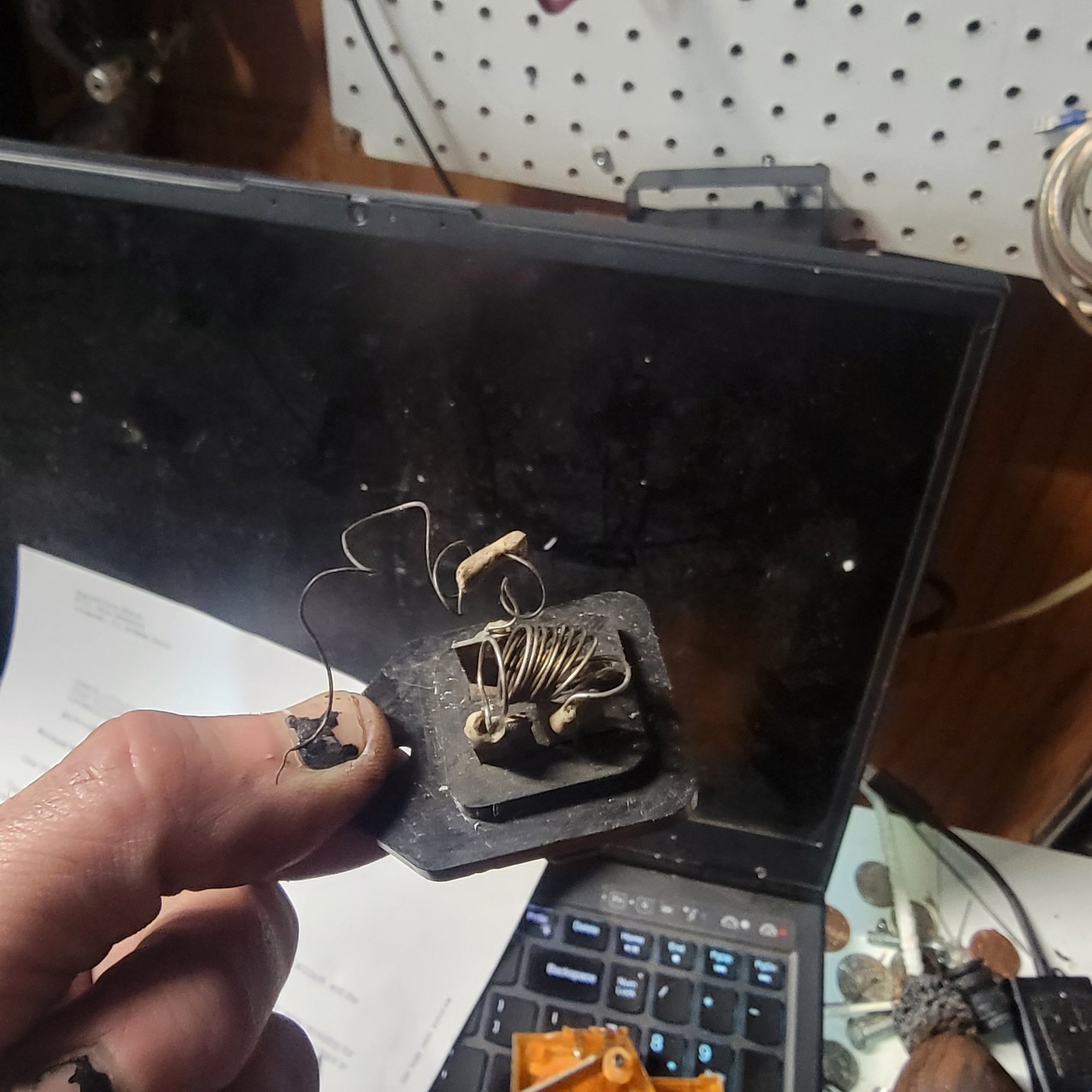

I keep getting told that I can run my truck without the ECM. Yes its carbureted but it's an electric choke. Furthermore what I was reading on the internet and as well as watching a painstakingly long explanation as this guy went through an entire wiring diagram of a starting circuit for a couple of different vehicles I don't understand how it is that people are telling me I can run it without the ECM especially because I'm in California, this place sucks. But I've heard things like the fact that the ECM controls the ignition timing, reads the signal generator. However multiple people have put it to me saying that it literally just records data is this correct? I mean hell I've had an AutoZone guy in California say the same thing and he's the Toyota guy. Was the ECM back then just for reporting to smog stations or whatever and does it still apply with the electric choke? Bear in mind I don't have any AC or compressor. I do have this lil doohickey.
Would someone tell me what the hickey doo please?

That 'dohickey' used to be the heater blower motor resistor.
The blower speed switch selectively shunts through one or more of the resistance coils in this to give several alternate blower speeds.
The one you picture is junk.
