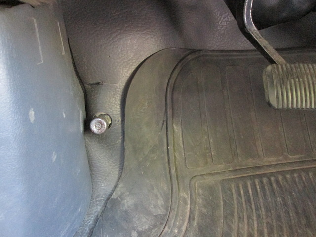

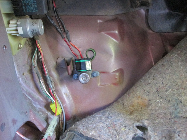

A floor mounted headlight dimmer switch works great as an alternative to the usual toggle switch for driving lights, the one I'm using on my 88 Toyota pickup is from an old Ford, it's mounted in a comfortable position next to the kick panel using 5/16 self drilling sheet metal screws.

I have a dead pedal in that spot i think. But i like this idea!
My high beam switch recently lost its "pull-to-flash" function and i keep forgetting, going to use it and it flashes a moment of total darkness instead. (At night that is.) This would be a fun alternative mod instead of just a repair.
I've been wanting to add lights to this truck forever, saying as soon as i get a new bumper worth putting them on! Eight years later... Still no lights or bumper. D'oh!

That's what I've been wanting to do as a temporary fix for my combo switch. Mine is loose in the detent or whatever holds the stalk in whichever position you have it in. I end up flashing every time I hit a bump. I don't want to be flashing my lights at a cop and end up a DWI suspect. I've got a couple bad joints in my feet and I'm not sure I could walk the line.
Do you remember what your circuit ended up looking like. I'm not sure which wires to run to the switch.
