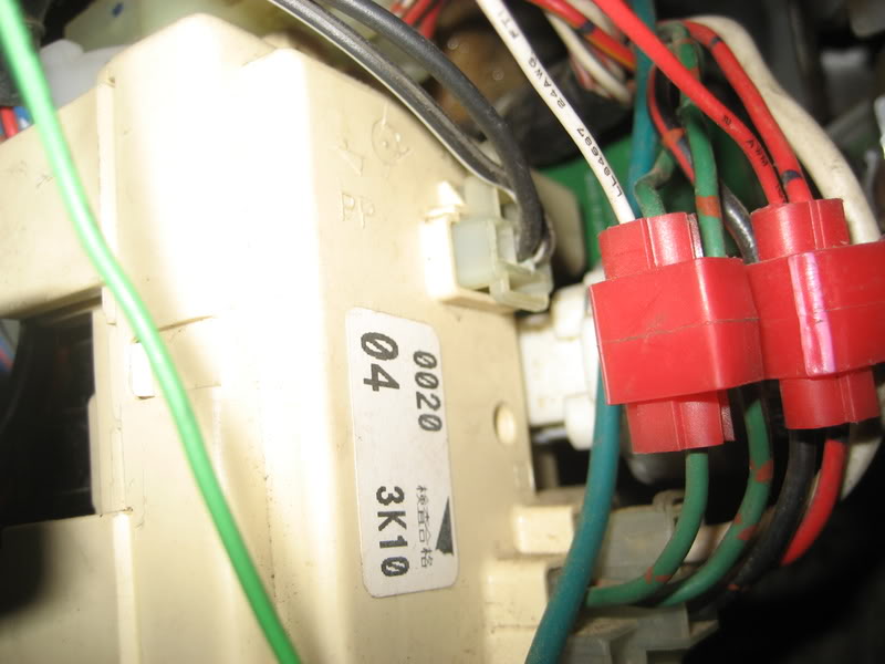

Well, I got a little bit insane about this issue today so I tore apart my entire dash. I managed to learn a lot in the process, so I don't regret it. The good news is that I got my dome light and door sensors working!
A picture of the teardown in process:
I couldn't find a buzzer box, so I'm sure the PO removed it. However, I was able to see where the door sensors were cut, and most importantly, where the dome light sensor was completely disconnected! I could have fixed the dome light very easily, but it wasn't until I tore everything down that I was able to figure out where I should look. The offending plug that was disconnected is shown in this picture, under the driver side kick panel next to the fuse box (black and black/white plug top left).
Thanks for your help, glad I could figure this out out by myself and learn more about my truck.
glad you found your problem...now get rid of those red scotch locks!!!
Those things are assuring that your connection will come loose one day....and soon. THose are OK for troubleshooting but not a permanent connection!
