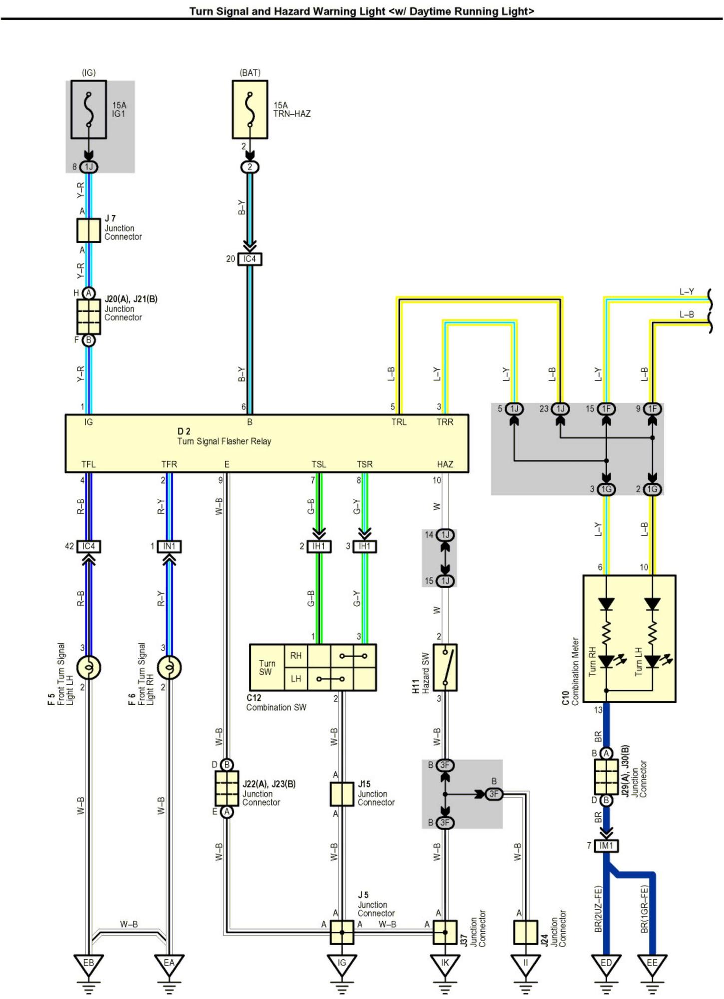

Hello. I want to disable the DRL/flasher lights on my 2008 Toyota 4Runner 4.0L V6 4WD Limited Edition. I have done a lot of research and have a quick question regarding this thread: https://www.yotatech.com/forums/f127...ability-92211/
If I was to just cut the D2 Pin12 = light Green/Red Stripe wire and just seal the ends, it would effectively disable the DRL lights without disabling the turn signals or causing any problems, right?
OR
Am I better off buying the non-DRL relay?

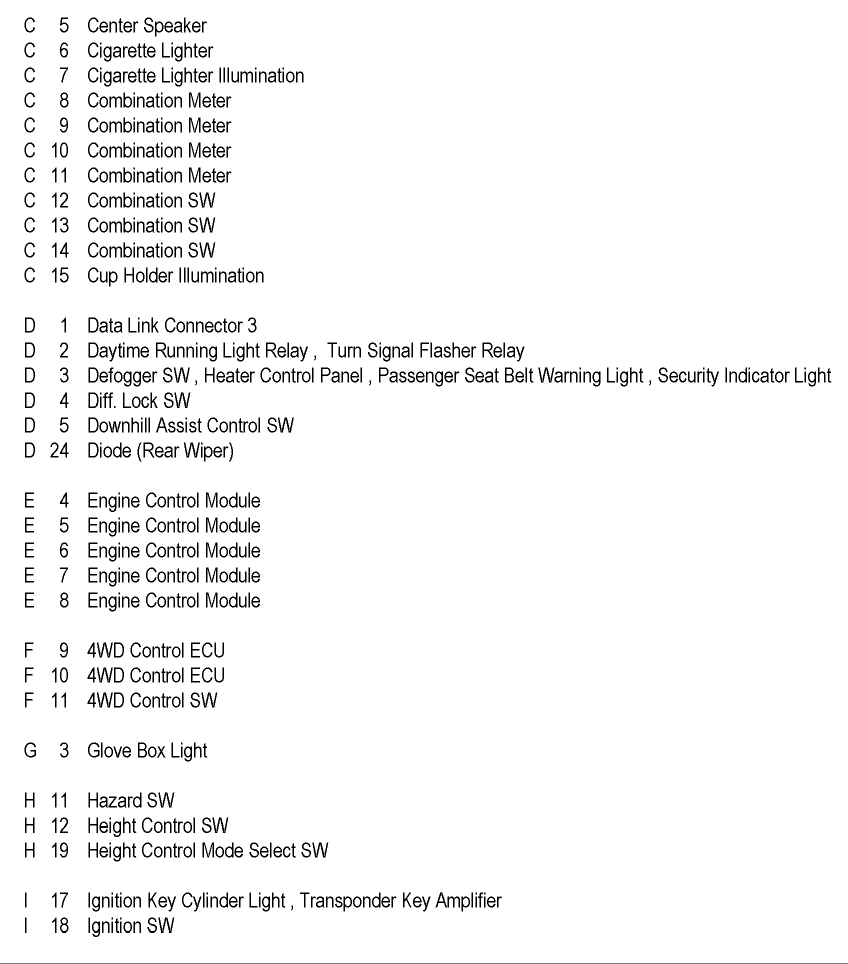

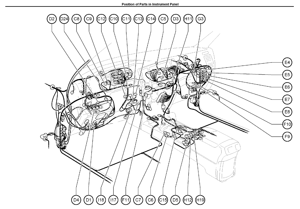

Here are some diagrams:
Here is the connector I have:
Here is the non-DRL connector:
