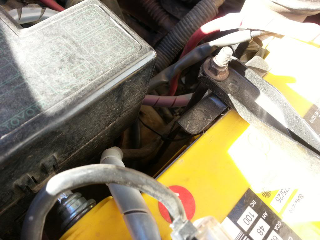

Here's my zip-tie setup as of now. It prevents the battery from hitting the power steering reservoir, but now the negative battery terminal hits the fender:

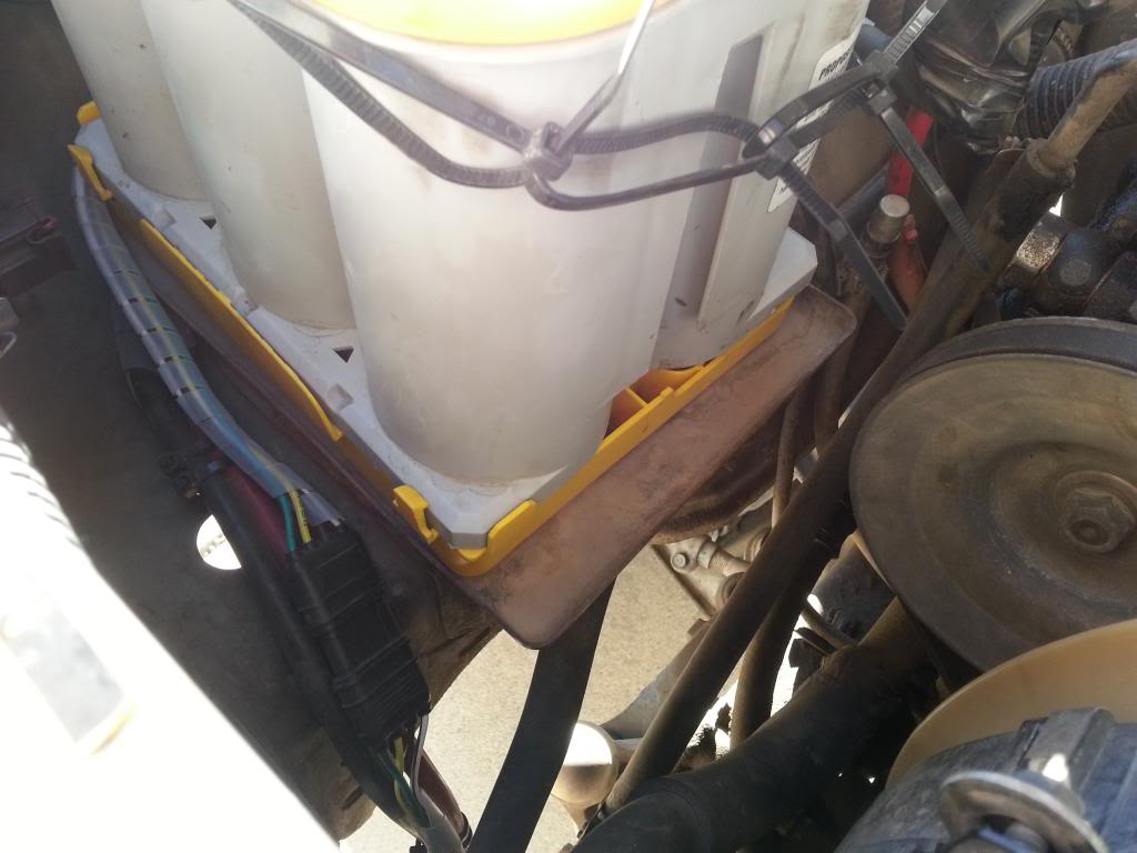

The front part of the hold down is fine, but as you can see here, the rear part doesn't hold anything:

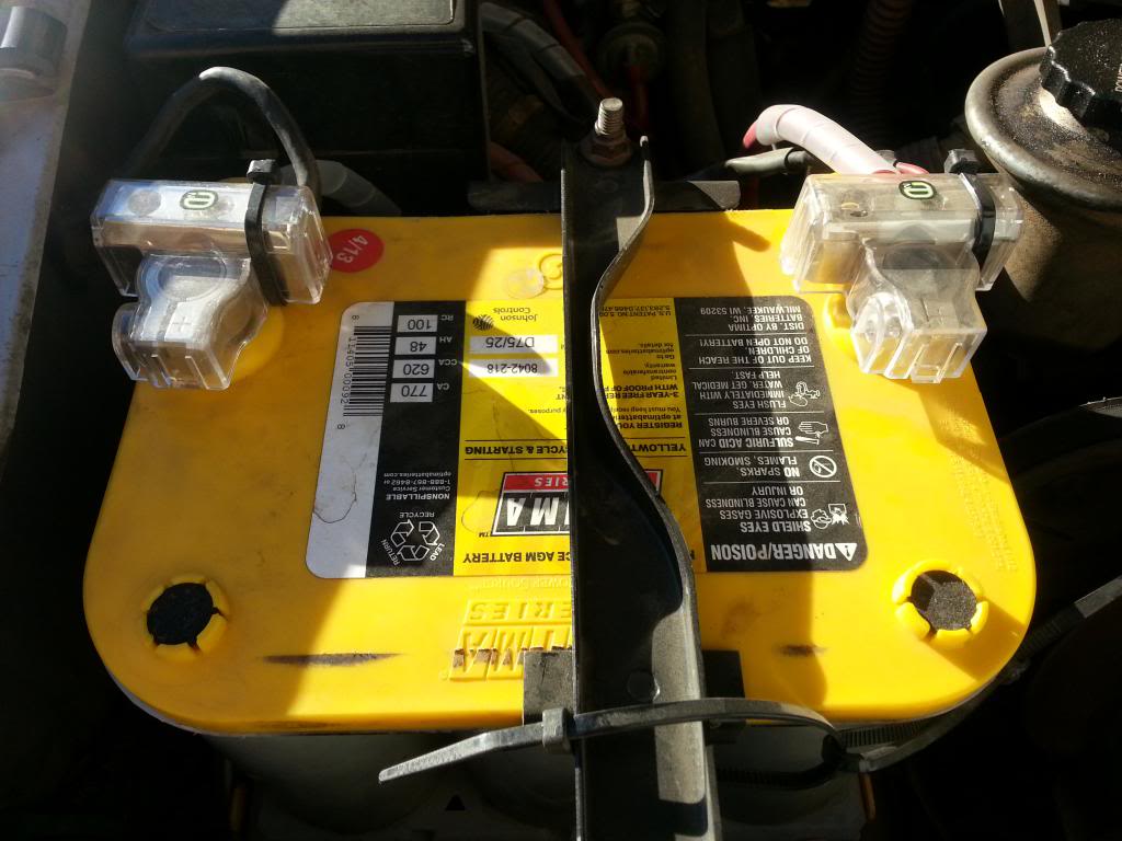

And here's a pic of the battery tray. Also note that I am already using the provided spacer:

I think another 1/4" or 3/8" of spacer will cure your problem.
a piece of plastic angle to fit on the side that does not fit against the battery.
modify your top piece so it fits tighter to the battery
simple fix is put a few flat washers on the j-hook to allow more tension on the battery case.
if it is not tight no matter what you do it will still slide and bounce around
I feel sorry for you best of luck

Looks like you bought too small of optima to me. I could have sworn I have seen optima batteries fit perfectly.
edit- also looks like the aux positive post should be covered or could still short on the reservoir.
You seriously need to make a spacer...I wouldn't trust those tiny (Harbor freight?) Zip ties...

My OEM battery size is a group 25. This is the correct battery for my application, according to Optima's website.
I have post covers on both top posts, which are zip-tied in place. I don't have covers for the side posts though. (I had to use an extension piece so I could install my winch circuit breakers directly to the positive side terminal)

I see it's been answered but yes, your optima is too small. The newer ones are smaller I think. My red top doesn't fit either. I hammered the hold down and it grips pretty good now. You've just got to work with it or really dedicate to the optima and weld in a box for it.
EDIT:
The problem is that it's too skinny. Wedge something between the front of the battery and the clamp on your holder. Or cut off your clamp, move it backward to fit more flush on the battery, weld it in place. Of you can't weld, get a shop to. Won't cost hardly anything but will give you piece of mind.
