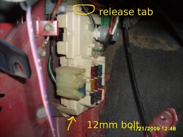

I have had to make some major repairs to my fuse box harness due to corrosion....Now I need help. Can anyone post a picture of the long skinny plug that goes into the back of the fuse box the one in the cab in front of the driver side door. I repaired the wires that corroded and fell off now I need to know where they go. A diagram would help but if anyone has a photo laying around that would be the easiest. My truck is a 91 4x4 with a 22re. Thank you so much!
It would be the plug that goes in the back side of this little guy. (google image)
I have looked at all the wiring diagrams and it isn't helping. It appears that I have everything re-pinned correctly. But I am getting no power to the fuses If I jam a hot wire under the fuses from the out side it will start and my heat/radio etc.. work but then nothing turns off when I remove the key so thats no good. I also lost my headlights. The tail/brake lights work but no headlights. If I power the Headlight relay fuses in the engine fusebox both headlights turn on.....I am completely stumped so if you have any ideas/pictures that could help me I would appreciate it! Thanks!
