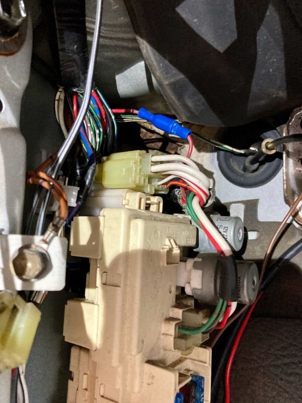

I think I found the culprit: dug around more under the dash and discovered that both headlight grounds (red-green and red-yellow) go through this big connector on the top of "Junction Block 1" behind driver's kick panel. Hard to see back in there, but the red-green pin is noticeably blackened compared to others. Guess I need to clean, replace, or bypass that connection (also, I could be wrong but I think a small piece of metal fell out of there, when I initially pulled the big plug out, geez... who knows).

Anyway, I got the problem fixed and she's back on the road. The red-green connection at Junction Box 1 was definitely bad/smoked, so I bypassed it and added a little bullet connector: problem fixed and I've got low and high beams again.
