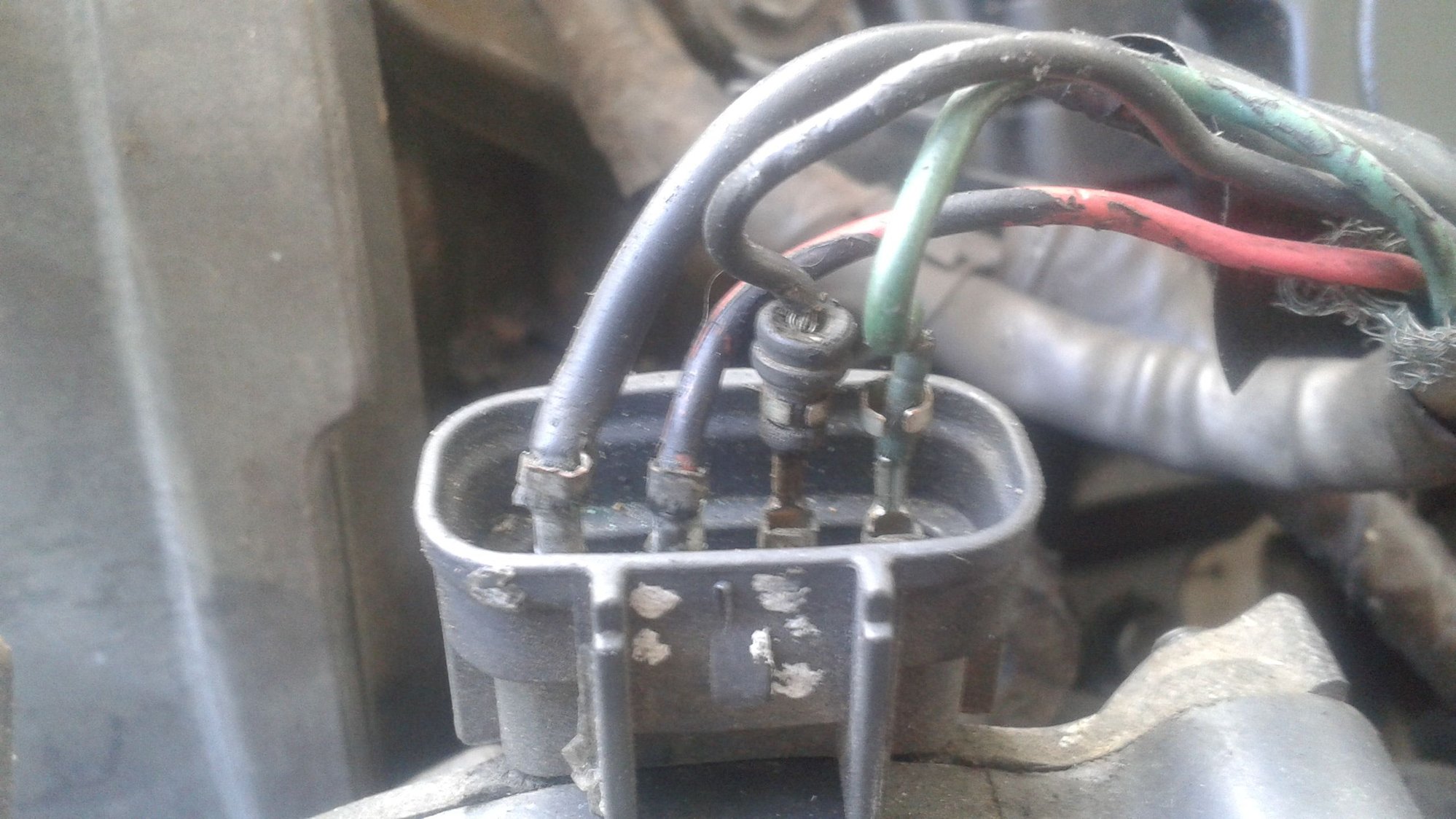

I just bought an 89 pickup with a 90 3vze engine according to the seller it was running till his 4runner blew up and he was gonna swap engines so he started unplugging things and cut every vacuum and water line. I got all the lines replaced and tested all the fuses and im getting fire from the coil to the cap but not to my plugs. Ive replaced cap and rotor and when I went to start testing the harness to distributor I come to find they have been cut and spliced directly into the harness. from harness to distributor he had red to white, green to yellow, black to red, and white to green... I know thats not right but if someone could show me a picture of the connectors from harness to distributor where I can clearly see what wire is running to what wire id b very grateful ive been looking for a couple of weeks and cant find a picture or a person who owns a 90 4runner/pickup to look at for comparison

1991 3vze Distributor Harness Wires.
I hope this helps, the plug rotted and I had to do some surgery to keep her running, but you can see the cables and where they go
