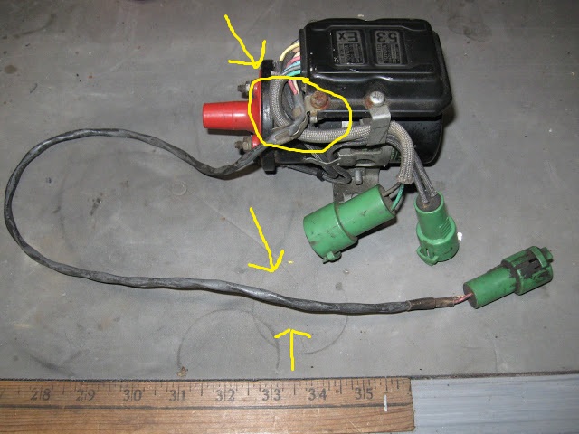

I need some help here i have been farting around with this problem and im sure its simple. 88 4runner with 416,000 miles (and doesnt leak a drop lol ) When starting no matter hot or cold it cranks long and i have to feather the gas to get her started. Onces she's started she runs like crap for about 10-15 seconds and you can smell strong exhaust for that time. Then she runs fine and drives great. I'm thinking it may be the igniter but not sure. The wire connection from the igniter to the distributer has 2 wires router to the connector and a 3rd wire wrapped around the grey sheath which does connect to the igniter on one side but not sure about the other. In the pic i have circled there are actually 3 wires 2 sheathed and one that appears to be a ground which is not visible, does that ground wire connect to anything? It may just be sheath protection but i wanted to know for sure. If you've had this problem please let me know how to fix it. Thanks

I have to ask when was your last Major tune up??
The whole nine yards !!
How long has this been happening??
Most igniter and coil problems that are intermittent seem to occur once they get hot.
Just what do you mean by long cranking??
Stepping on the pedal just gives it more air not fuel if you are stating your engine correct as a 22rec and not a 22r.
Fuel injection or carburetor
These engines when tuned correct most often fire right off I know mine do .
