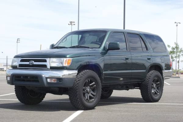

Well I ended up picking it regardless. I still havent had any luck finding out the cause of the issue.
Here's a pic of her
Attached Thumbnails 3rd Gen 4runner: Turn Signal causing downshifting-00303_asdrizhknmn_600x450.jpg
