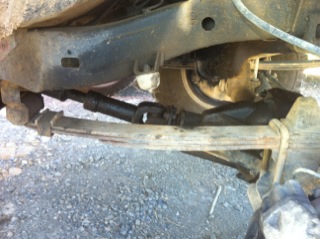

Is it me, or is there a lift block under the springs? Take a look at the pinion angle too. No way to get that angle without a severe degree shim.
But, its not a Skyjacker issue anyway. The springs bent because they were allowed to negative arch on a regular basis.

Good eye! I'm seeing that too now(@400% zoom) It's pretty clear there is a block under them.
Can you say AXLE WRAP CITY? What a dumbass!
They don't look angled to me. But he likely clocked the perches to get that pinion angle.

Little, more like a lot. I thought they were kinda Verboten on the rear even. But on the front, Oy

im sure overtightened u-bolts (ya know, for fear of kicking out the blocks) would add to the problem also.
they just don't make them like they used to, cause my ruf's love to go negative

#1: They aren't upside down or in the wrong position. Are you serious? How else could they be fitted? Think about it.
#2: Oh...I highly doubt that could be achieved or that it could possibly make even the slightest difference it were to be. Meaning...it wouldn't hold the blocks in place any better necessarily nor would it effect the springs in a negative manner if the bolts were a little tighter than specs. It could very well damage the blocks though.(Ask me how I know...better yet don't...I hate talking about that fiasco)
#3: Hmmm...possibly they don't make them like they used to, BUT definitely they don't like to "go negative". Springs aren't meant to do that EVER!

Originally Posted by xxxtreme22r
man to me now that I am looking at that shackle, it looks like that shackle is not a shackle at all and its a half a shackle welded to the frame too. Also it doesn't look like there is that body mount even there.
If you zoom in on that spot it looks like it IS welded to the frame. So i think you may be right

I'm glad I am not the only one who sees it that way. I understand what DC was saying though about not seeing half the shackle, but that don't look like dirt between the shackle and the frame to me.

it appears that a skyjacker lift kit simply turned into a universal skyjacker block and ubolts bought at any parts house. the ideal lift kit is the blocks and CRANK the t-bars.

K. I talked to my buddy today and Im goin out there tomorrow to help him put a body lift on his truck. BUT I asked him some questions
1. He said that is how the springs were shipped to him, he hasnt removed any leafs and no overload springs came on it(its the front).
2. That shackle is not welded to the frame and it can move, the picture just makes it look that way, ill take more pics when I go out there tomorrow.
3. That isnt a block its a shim to help his drive shaft angle.
and 4. Those u-bolts are on there right, he would know because they have 3 of those trucks out there at thier house.
