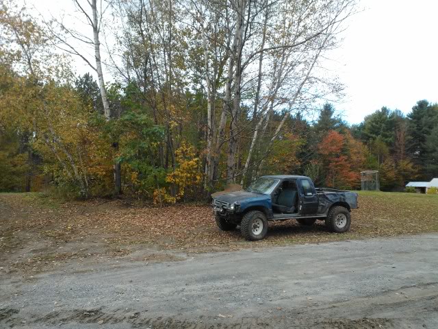

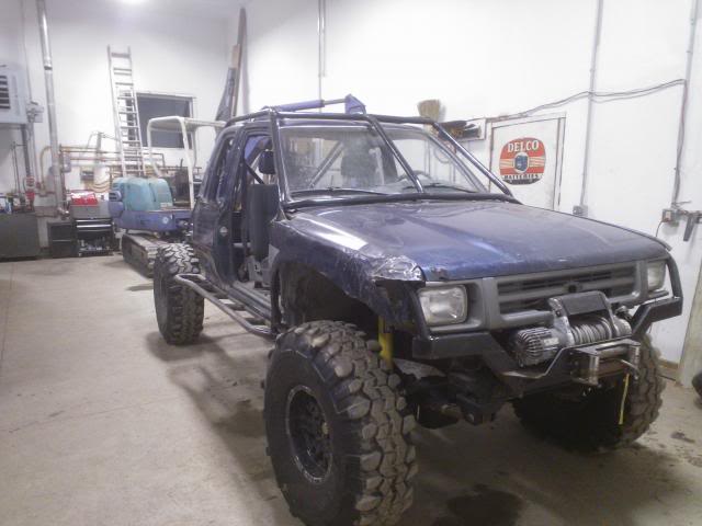

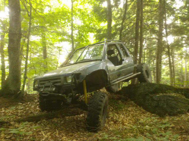

Getting the IFS trucks and tacomas to sit that low is more challenging do MUCH less arch in the front frame. With out chopping up the frame the only place to put the axle is below it.
I have a 3rd gen, 3" total lift from the SAS/chevys with 38. 2-3" up travel in the front, cut fenders... Its hard to get it that low without re doing the front of the frame..
I was running 35s stock on the IFS with just the cut fenders, but the ifs didnt like it. 0 Lift

Solid axle pics. 3" total lift over stock, 38s.
If I had bigger tires or if it was any lower, I would need to remove more sheet metal, on both the firewall and under air and battery boxs.
