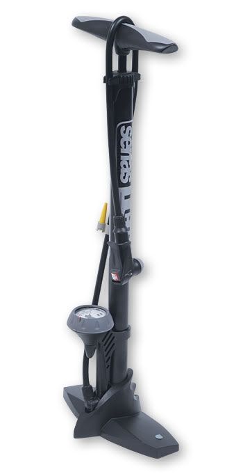

The simplest air compressor I ever used . . . .
Old Apr 26, 2006 | 11:30 AM
Tacoclimber's Avatar
Joined: Dec 2003
Posts: 3,659
From: Between a rock and a hard place, AZ
Dude, if you can air up a 33" M/T with that thing, "you're a better man than I, Gunga Dinn!:
Old Apr 26, 2006 | 11:49 AM
Bobakazi's Avatar
Joined: Jan 2006
Posts: 378
From: Portland, OR
Can you imagine packing up to head home and you see somebody pumping up their tires with a bike pump? I suppose it would work if you were in a all-out bind, but that would be freakin hilarious!
