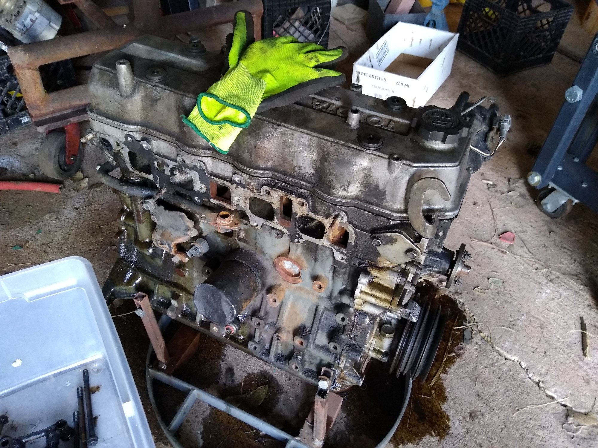

So my 82 22R is getting tired & needing some relief after 325,000 I picked up a 22RE core engine equally wore out and am looking at rebuild kits for the re while I continue to run my current engine. Obviously I can't order anything until I tear it down and check it out the core. I want to use quality parts when I build it, im a regular guy on a budget I'd like to save money if possible but not at the expense of quality. Is there a budget friendly kit out there I can trust or can I save money picking up the components separately?
Here is the kit I'm looking at right now, it's not cheap but looks like all top shelf parts . I'll be ordering a brand new complete head.
https://209yota1.com/products/22re-toyota-premium-master-engine-rebuild-kit-fits-1985-1995
(Link doesn't seem to work , it's $600 ) This Premium Master Engine Kit Includes:
  • Sealed Power Coated Piston Set with Pins and Clips
  • Hastings Chromoly Rings
  • Aisin Oil Pump (OE)
  • OSK Timing Set with Steel Guide (OE)
  • Timing Cover
  • Gasket Set (OE gaskets include head gasket, front and rear seals, timing cover, oil pump, 12 piece injector seal kit. All other gaskets in kit are top quality aftermarket)
  • King Main Bearings
  • King Rod Bearings
  • King Thrust Washers
  • Pin Bushings
  • Melling Brass Freeze Plugs
  • Block and Crank Plugs ( 9 pieces )
  • Head Bolt Set
