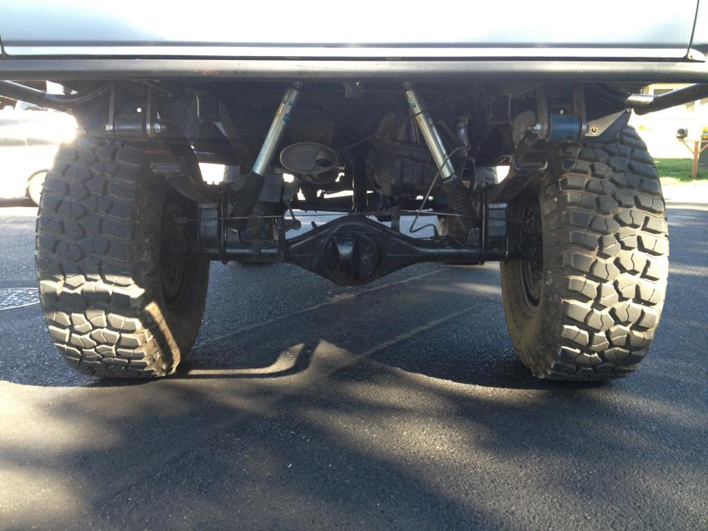

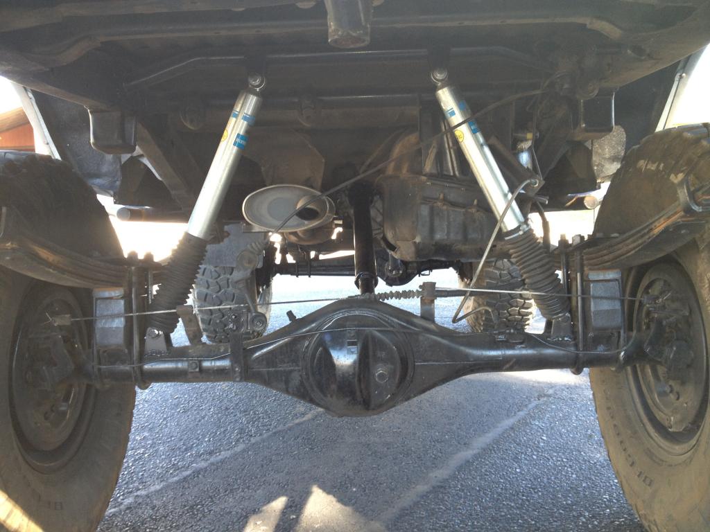

The rear setup:
Here's a list of what I'm looking to change:

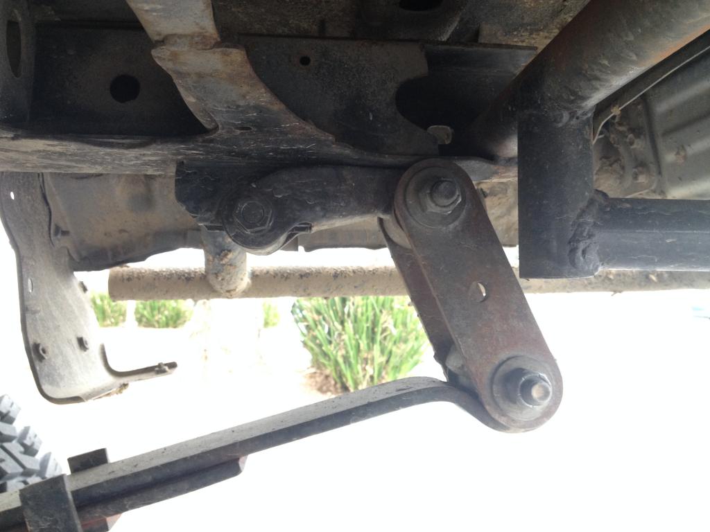

Here's a picture of the dual shackle setup:
Dual shackle setup: I want it gone, the truck feels like a deer learning how to walk in unstable/off camber situations and The dual shackle setup is causing too much unload. So what needs to be done? remove current hanger mount, measure 4-5" from original location, and a longer shackle or can I keep my current shackle?

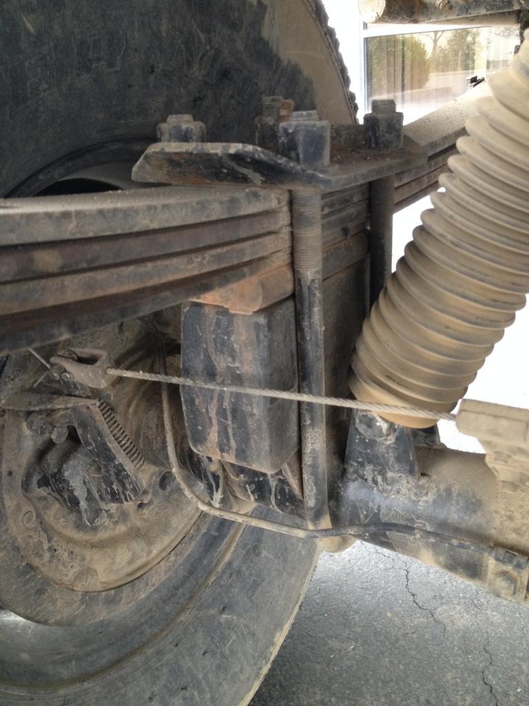

Here's a picture of the blocks:
Blocks: I want to lower the truck down a bit, and put it back on 35s. that way I can possibly fit it in the garage. Currently its got a 4" blocks and the overload spring is cut that offers about half an inch. So 4 1/2" of spacer lift just looks welfare - ish. I'd love to see the truck about 2 1/2" lower. So what kind of problems can I possibly run into by doing this? Pinion angle? shorter u bolts? the brake lines are routed under the springs, will I have to relocate them?
what's everybody's opinion? Basically im trying to drop it about 2" all around, ditch the 37s, get it on 35s, fit it in my garage and be overall more stable.
The rear setup:

As far as the shackle hanger goes. I figured I'd just put it exactly where the 2nd shackle meets the 1st shackle like this:
Anyone Object?

The ONLY thing im worried about right now is the fact that the parking break is BELOW the leaf springs, and if I lower it down 2 inches, itll hit. any remedies for that?

I extended my parking brake levers on the backing plates so the cables would clear the top of the springs. Disconnected and tied up the LSPV.
