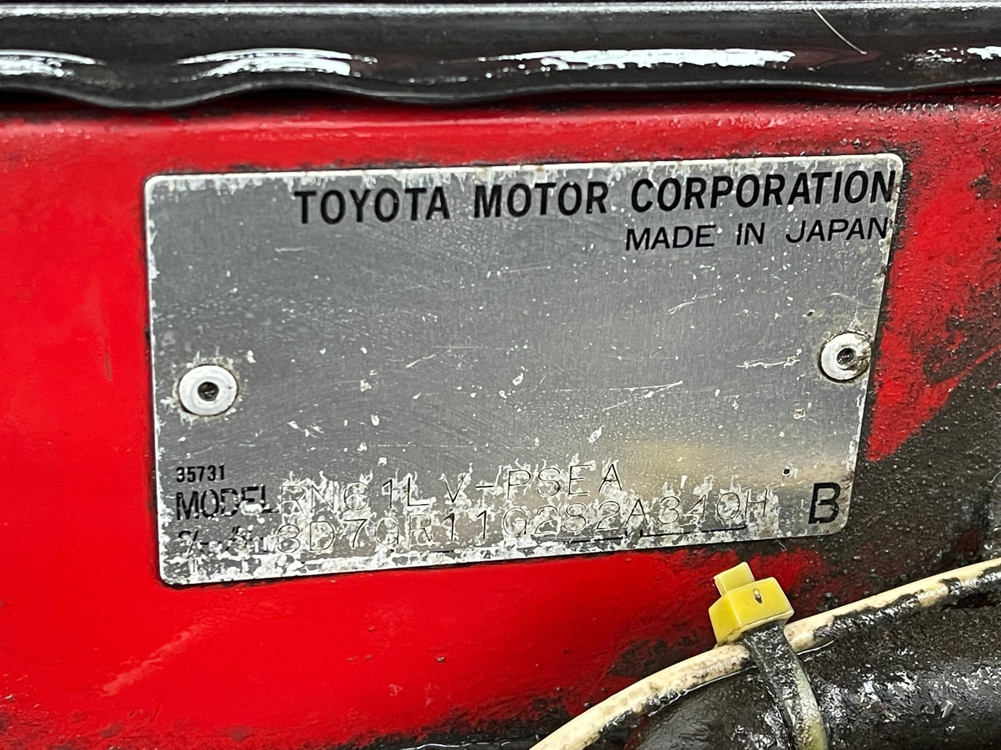

Do you have a tag on the firewall that has the trans code? It looks like this on my 87. Lower right says A340H

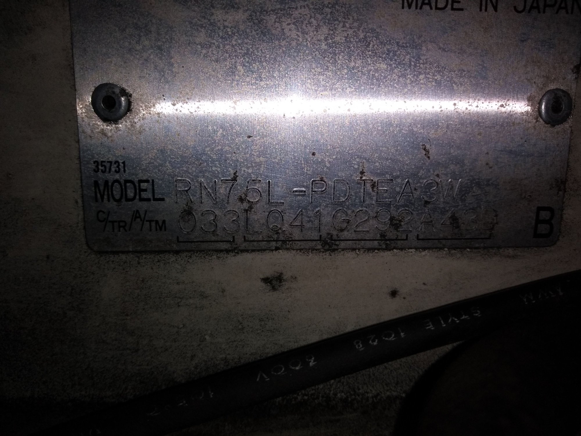

Old Aug 29, 2023 | 09:24 AM
Teach2's Avatar
Joined: Mar 2023
Posts: 4
This is the tag.
