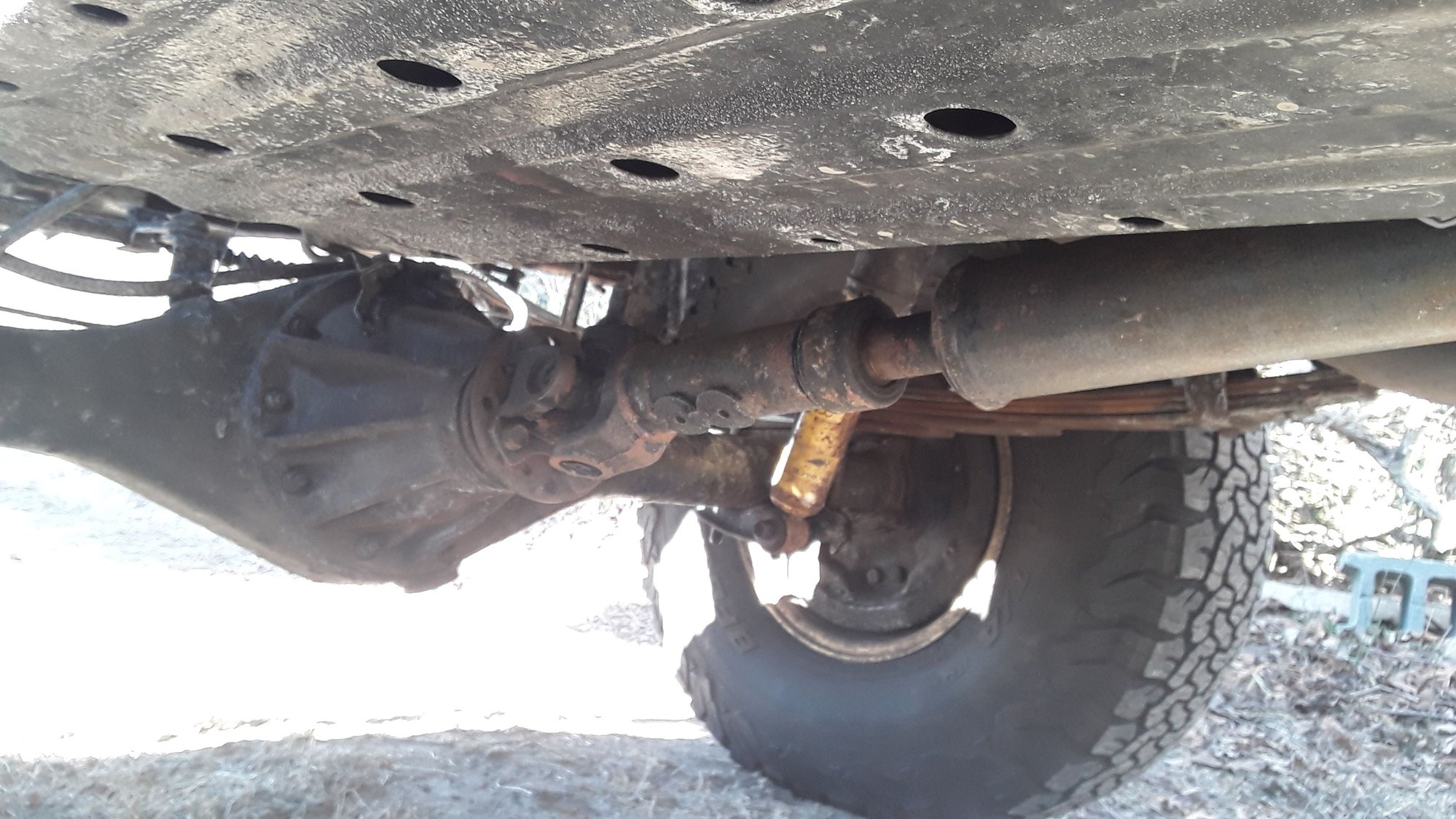

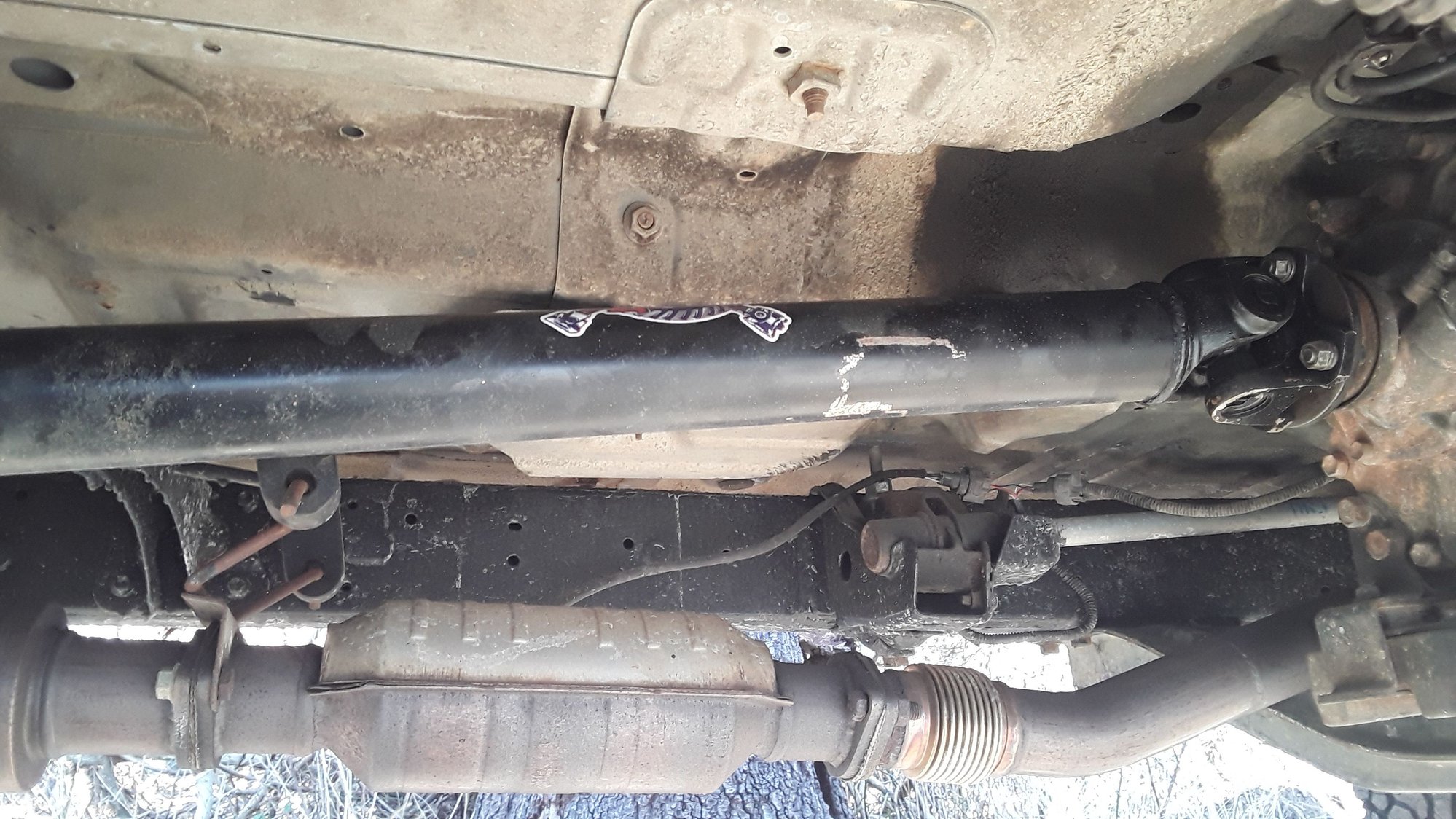

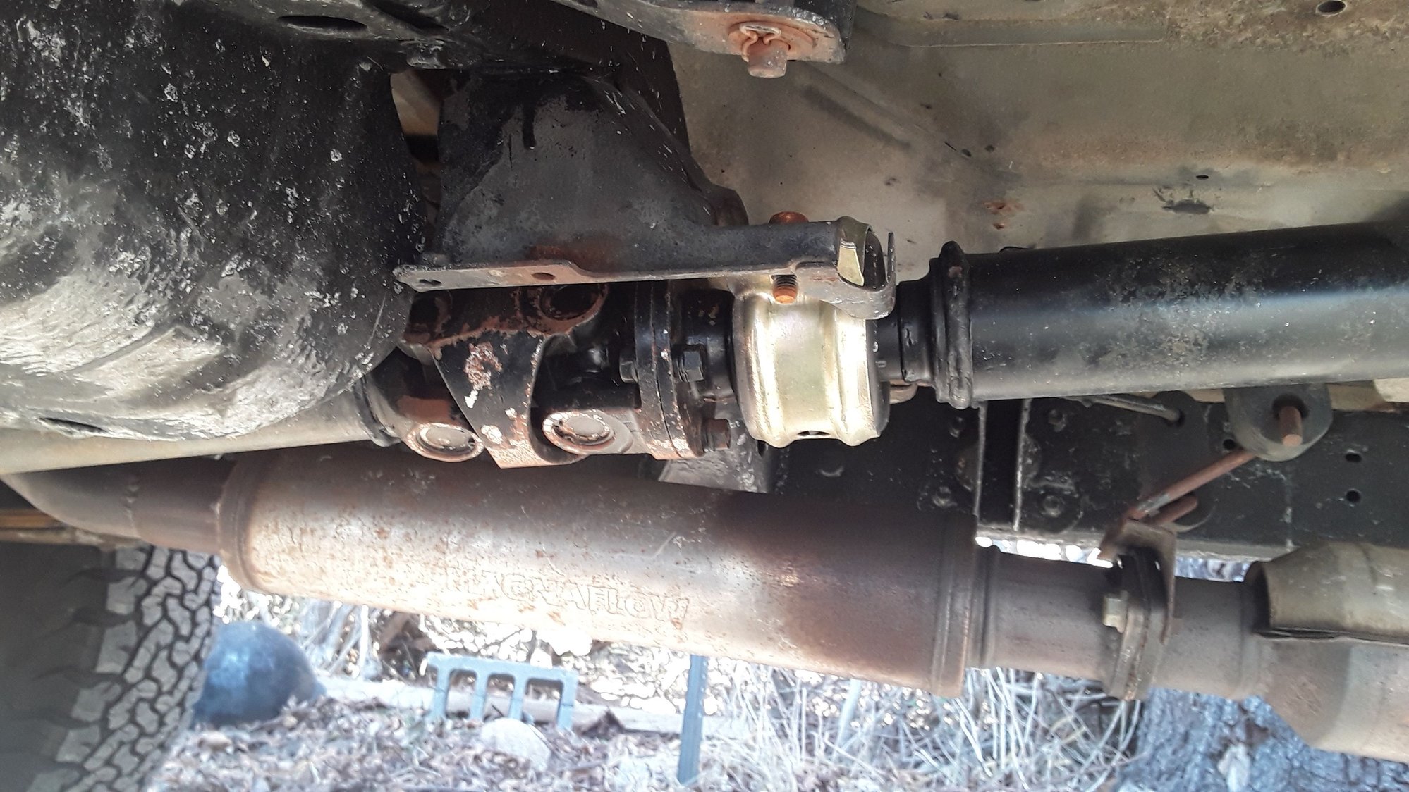

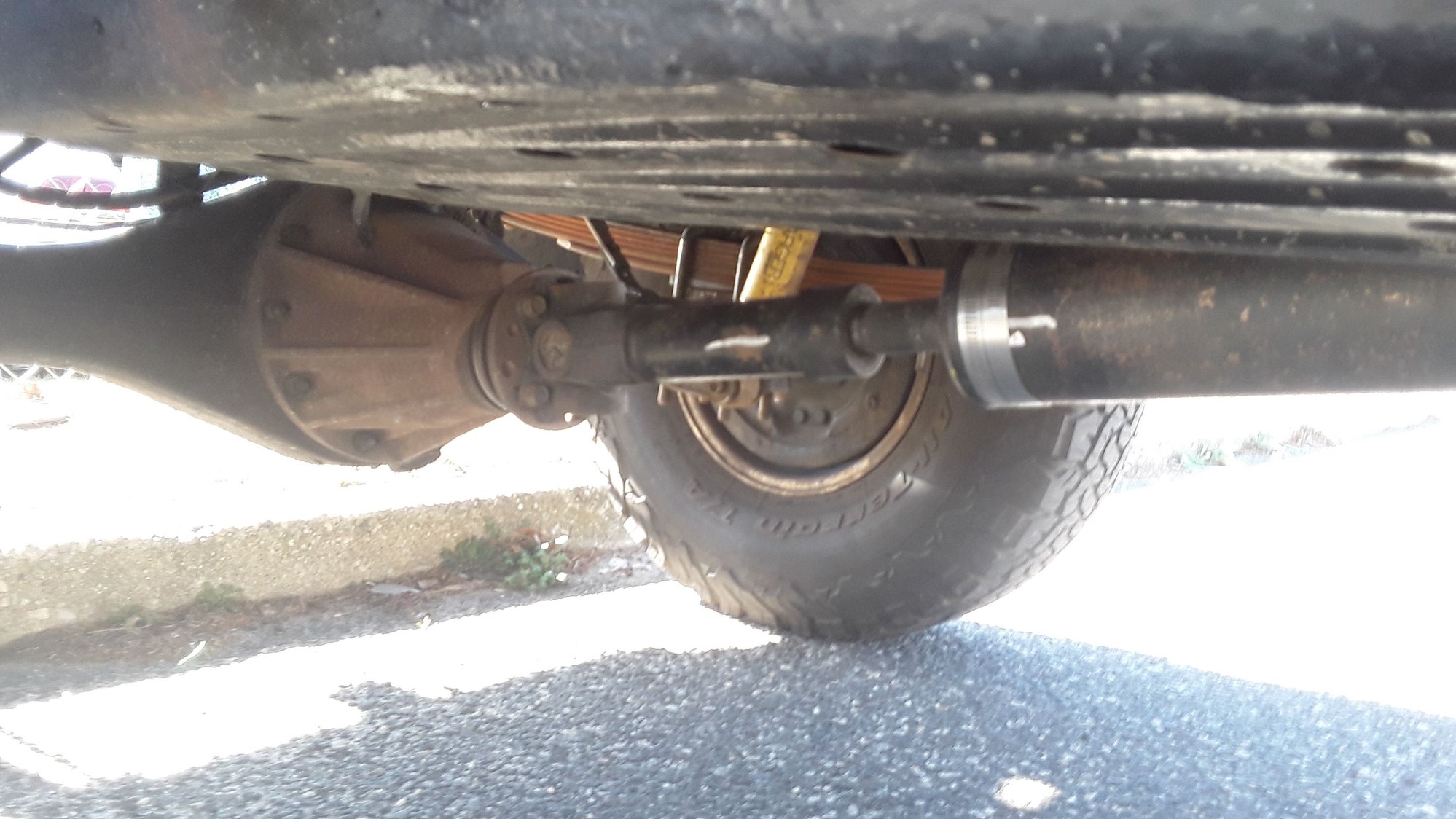

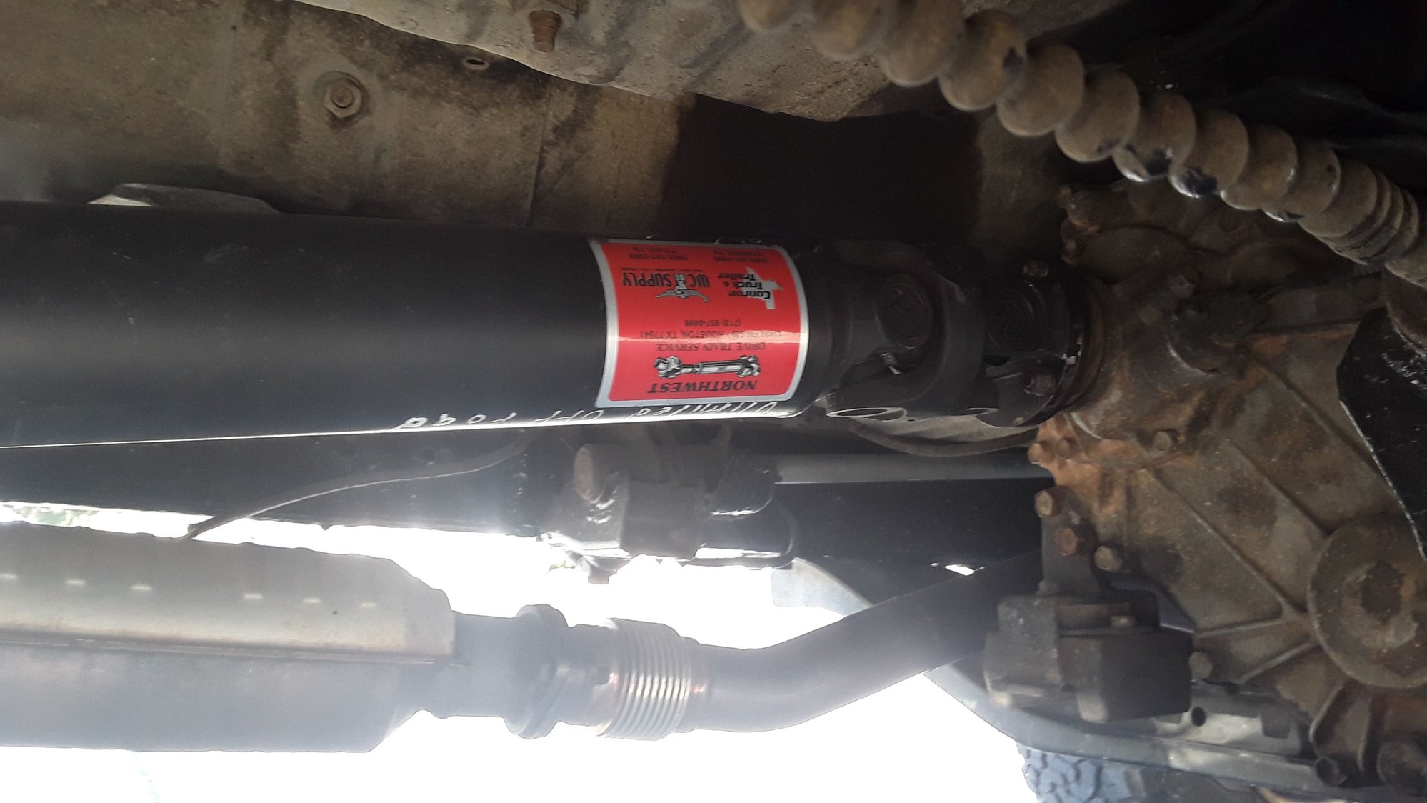

Finally able to install the extra shims and call this complete. A normal looking two piece driveshaft, required 8 degrees of pinion angle lift. Super smooth to 110 and back. Paint came off next day but no matter.
The shop said the old driveshaft had serious runout on either end. The lesson? extended cabs should not run a single piece for anything other than crawling.
before:
after:
