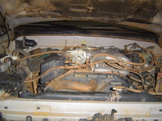

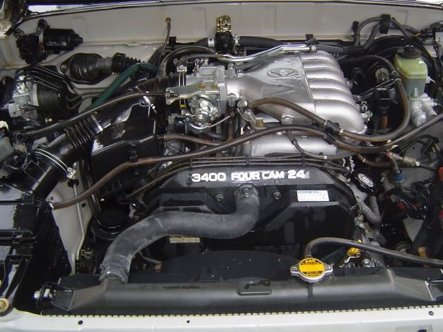

Well after a long day of mudding my engine was COVERED. I bought some Simple Green degreaser to clean it off and DAMN! This stuff works awesome. If you ever need to clean your engine compartment just a bottle of Simple green, spray it on, wait 10-15 minutes, hose it down and it should be shining!
Here are my before and after pics:
Before:
After:

also i think simple green will break down petroleum products like your rubber components on your motor thats why i use it first then blackmagic engine cleaner and brightner
like i said before cover well i used 6 plastic bags over the alternator and fuse box and well you dont have to cover the battery and i use a leaf blower to get rid of most of the water no problems at all
heres what mine looks like before..after
