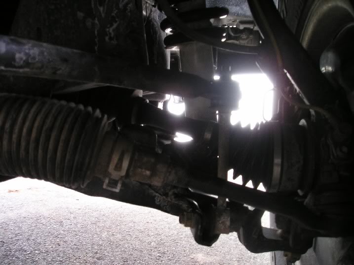

Only diff I notices was that the boots to the outer have fins that are quite a bit closer together and with my lift they do touch where as on my stock one they do not. I will take a pic to show what I mean. Not a huge deal though.

Wow, I wish someone would have told me NAPA had them earlier. I went around every where trying to find the CV before I tried NAPA. No junkyards have any newer runners here, so I couldnt find one there. I know what you mean about the boots. The pic below is my new CV, and the old one, had what seemed like much more clearence between the fins. I am alittle worried about the boots ripping, but they have held up fine for the first month. I thought it was just me. This is with about 3" of suspension lift, and the 1" Diff drop.

I got mine from Napa, but the boots bit the dust very quickly. Got a boot kit from Toyota for like $40 and put the Toyota boots on the halfshaft. They have done fine and the fins are not nearly as close together as they were on the ones from Napa.
