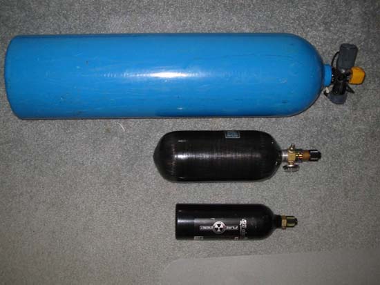

I scuba dive and play paintball (and now starting to wheel- not a good combination money wise for a high schoool student haha- that aside)
To compare compressed air to CO 2 I will use paintball guns.
I originally used CO 2 in my paintball guns. I used a 20 oz CO 2 tank which was supposed to get around 1350 balls per tank. So 20 oz CO 2 ~ 1350
I then switch to a 114 CI (huge tank) at 3000 PSI and expected 1140 balls per tank.
Now i don't have the exact Cubic Inches for the CO2 tank. But it is a good amount smaller in size, and gets more shots per tank. So there is more gas in the tank. I measure the circumference to be about 10.5 inches, and the length about 8. So 8 * 1.67^2 * 3.14 ~ 70.2 CI excluding the thinkness of the tank.
So
~114 CI compressed air = 1140 paintballs
~70.2 CI CO2 = 1350 balls.
I can write up some conversions later of what you should expect out of a 20lb CO2 tank verses a aluminum 80.... but that will take a while because i need to figure out some stuff. Scuba tanks are rated in size funny. An aluminum 80 is 80 Cubic Feet expanded. So at sea level an aluminum 80 would fill a room 80 cubic feet exactly to 14.6 PSI.
And one last thing for now, a picture of some tanks. An aluminum 80 is the blue one. The next one is a compressed air take 114 CI. The smallest tank is a 20 OZ CO 2 tank.
Attached Thumbnails Bargas / soda machine CO2 tank as OBA?-img_0027.jpg
