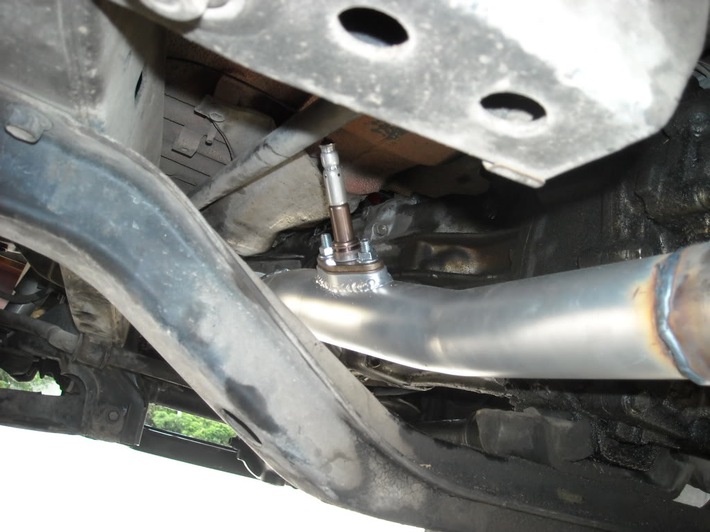

I'm not positive on this, but unless your 87 was manuf. in 11-87 and is actually an 88.... I haven't seen the 87's with anything but the "on the manifold" 02 Sensor. I've only messed with CALIF. Emissions 22RE's, for the most part... So in 88, it should have, like Pidasso mentioned, a Heated 02 RIGHT BEFORE the CAT.... and a 2nd Bank 02 Sensor as well, BEHIND the CAT. I've also never seen an 87 with a heated 02... It was still placed on the Manifold so it would get hot fast enough and get accurate readings, right from the 4-1 Collection area, above the collector........
Here's my 87 4Runner's factory 02 Location/Single Wire.........

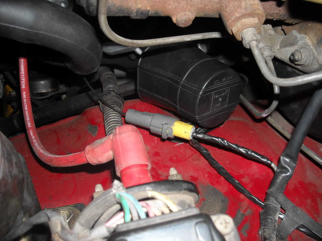

Here is the wiring connector Pidasso was speaking off, coming out right under the Cruise Control Actuator and wearing a Yellow Connector.......

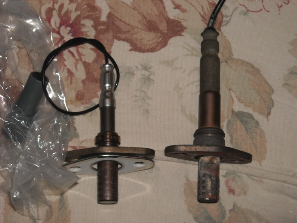

Here is the comparison of the NEW-Aftermarket Denso 02 Sensor on the left and OEM original on the right(Original had a Shielded wire on the 02 Wiring side... The Newer ones, even another Dealer one I had, did not have the shielding any more).......

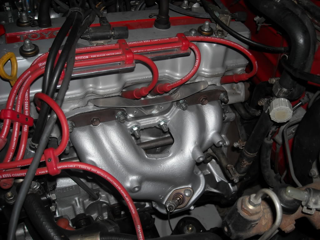

Here's where it is on my LCE 4-1 Header PRE-CAT Pipe(Which is where the 88+ had it located)......
