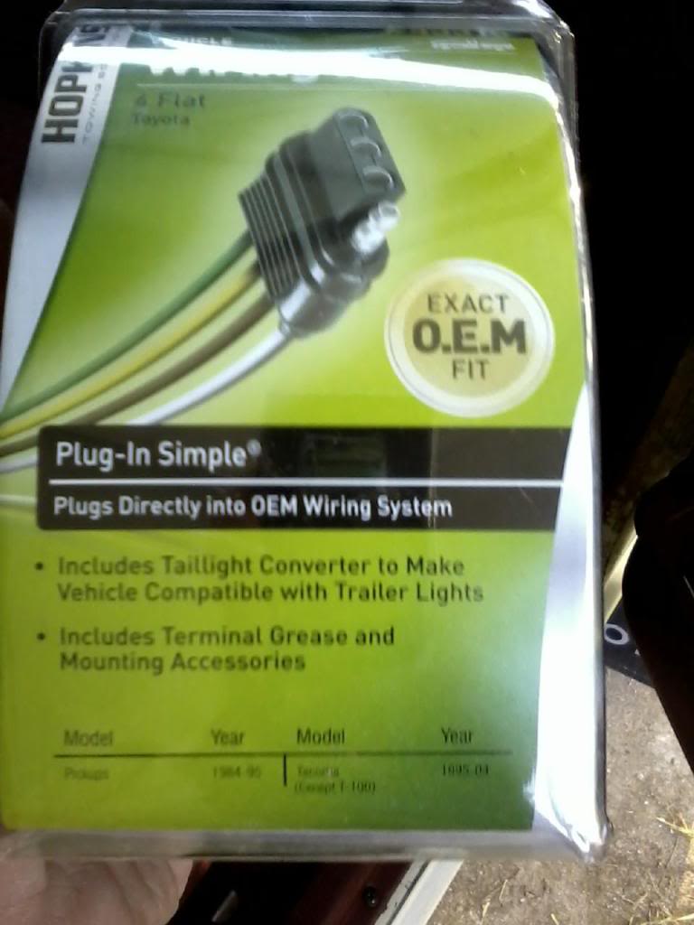

I use the following kit. It is plug and play. Sometimes you have to wait for the box to charge a little it seems to me. If you are having problems with your connection I would suspect trouble from truck to trailer.
PN#43315 and I get it from Orielly.

Yeah, what Terry posted makes it super simple. It's what I used. I hear they only last a couple years then crap out, based on some of the reviews, but whatever. It's so simple it's worth it.

I installed one 5 years ago and it is still working. I do keep the cover on the plug and spray the terminals down with WD-40 to keep them from corroding.
