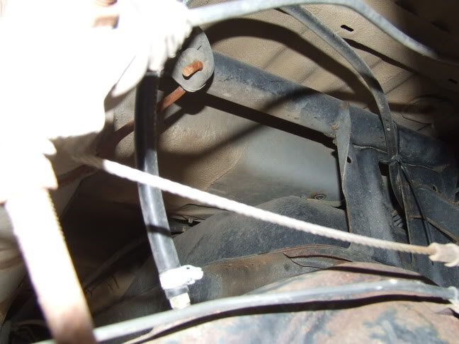

Here is my Front and Rear extended diff breather mod post from another forum.
Extended Breathers....
I finally got around to taking pics of my extended breathers.
For the REAR....
I went to my Toyota Dealer and told him what I wanted to do. He came up with a part. Some 4x4 sites have stated that you can just go to Home Depot and use one of their brass fittings. But this is not true (I tried it). The thread count is different. Sure you could cram it on, but I don't work like that.
After choking on the price of fuel line hose at NAPA.........I stumbled upon the perfect fuel line hose sold by the foot at Lowes. Great price!
I inserted the Toyota brass fitting.
I ran the hose up along the inside of my gas tank filler area.
I put the old spring loaded factory breather back on the top end of my new hose and zip tied it way up as high as I could just behind the gas tank filler.
I left enough slak in the hose for articulation.

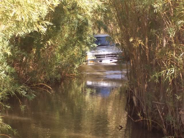

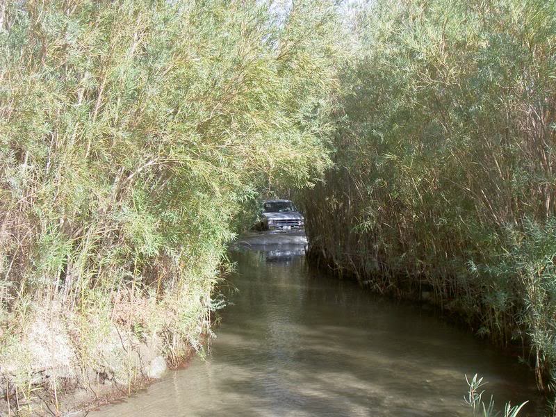

And it works!
Coyote Canyon....Anza~Borrego, CA.
Always remember to make a good Bow Wave!
