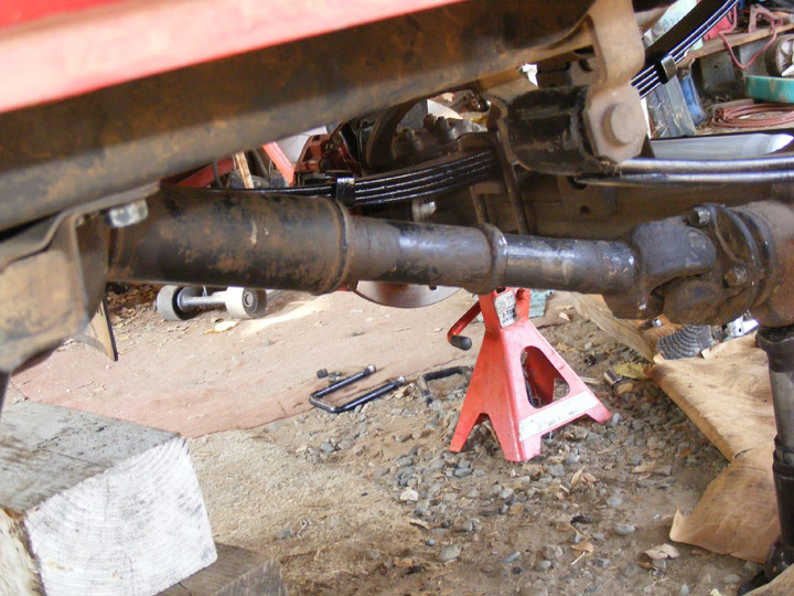

Won't work without extending driveshafts for sure. Even my 4" lift is really pushing the limits and I expect it to fall out any minute now.

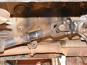

front shaft almost maxed out:

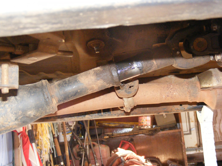

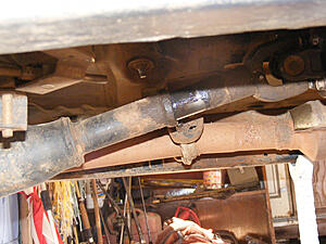

rear shaft extended alot too :
