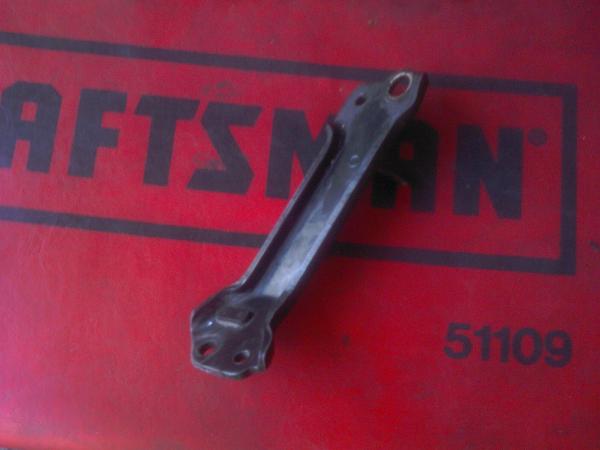

Haven't worked on a Yota in years. I have the intake chamber and timing belt out on a friend's truck, and now I'm having trouble remembering where this piece goes and what it is. Looks like some sort of support for the intake chamber, but I can't tell where it goes. Anyone care to enlighten me?

might help if we knew what year and engine size.

Sorry, good point. it's for a '92 3vze. I found a picture in the Chiltons manual, so I think I have the bracket covered. Any help on the vacuum hose picture would still be appreciated. The diagrams in the manuals for the vacuum hoses aren't very helpful. Should have taken a picture before I took it apart...

That is the bracket for the intake manifold that bolts above the exhaust manifold on the passengers side:

X2. I recognized it before I read the engine ID post.

Thanks for the pics - huge help!
