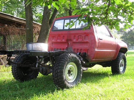

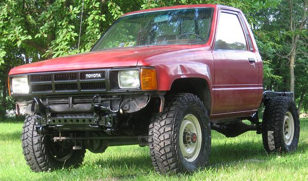

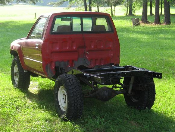

tire rubs on the passenger side rear, perfect on the drivers. is there any adjustments or is the frame just bent???????????

Per your SN, I'll assume it's an 85. Since you didn't state one way or the other, I'll assume you still have the 85 rear axle. After all my assumptions, I'll recommend you swap the rear axle to a newer IFS rear axle, since they are wider. You can get one out of 86-95 Pickups, or 86-89 4Runners. Depending on which one you get, you may have to move the brackets for the leaf springs, to match the width on your 85(?). Or, you could just run some wheel spacers. Oh, and your frame could be bent, but there is no possible way to tell based on those pictures. Good luck.

thanks.....it is an 85, all stock, found it in a rotting in a field. had to repair the frame(between the cab and the bed mounts). im thinking it might have warped alittle before or after the repair wasnt sure i took a few measurements and they where in spec. im bummed, thought she was ready to ride. any idea how much wider the newer axles are?

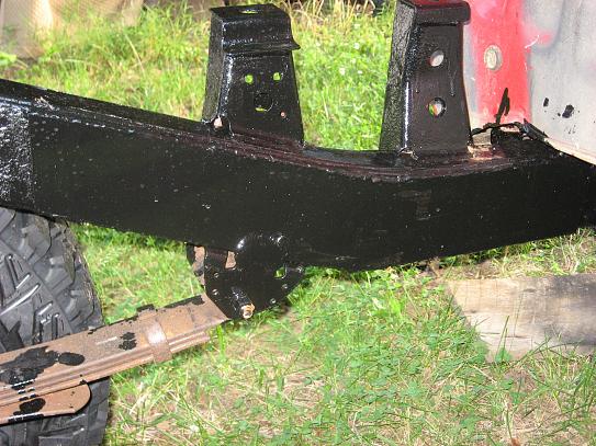

rusty85yota's Avatar
Joined: Jan 2010
Posts: 5
a few frame pics..... POR 15'd......thats some crazy s@#t. best paint for metal ive ever seen/used!!!
Attached Thumbnails tire rubbing on passenger side-img_2279.jpg   tire rubbing on passenger side-img_2278.jpg   tire rubbing on passenger side-img_2280.jpg

The IFS axle housing is 58" wide, compared to yours at 55". That alone would give you the clearance you need.

you mounted larger tires on wheels that are designed for narrow stock tires (like 225/75/15's). I am surprised that you are not having rubbing on your front springs. Not sure what size tires you used but they look like they are bulging a lot. Might consider going to a wider wheel with a different backspacing.
The IFS axle is a bolt on, plus you gain better(larger) rear drums. If you add the wider rear axle you will need to add 1.5" wheel spacers upfront to match the track width of the IFS axle.
IMO, the easiest thing would be either a different wheel (7-8" wide VS. your stock 6" wide) wheel or a set of 1.5" wheel spacers on all 4 wheels

Thanks for the help. I put 31x10.5 mtr w/kevlars on stock 88 wheels kinda dumb but it looks cool def... going to get new wheels before I take her out
