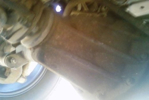

third member ribs-010500_1420-00-.jpgdriver side
third member ribs-010500_1421-00-.jpgpassenger side

That is a 4cyl 3rd.

yea what i thought lol now i have to see what kind of gears are in there i was goin by my axle code which would be wrong do to this
