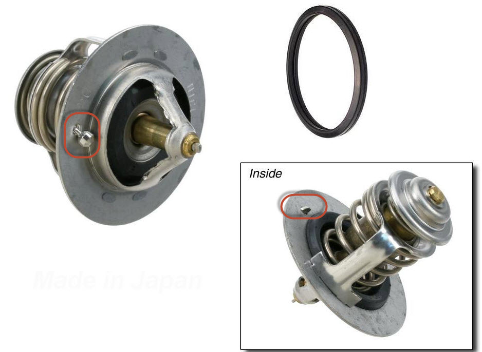

Is the thermostat the right one (correct temp rating) and installed the correct way...pointng the right way and with the jiggler at 12:00 o'clock?
3.0s seem to have a way of trapping air in the system. Make sure you 'burp" it to get all of the air out. http://toyotarepair3.blogspot.com/20...nt-system.html

Toyota t-stats have them....not sure what the technical name is, but is jiggles. Most likely culprit since you just changed fluids is air in system

Oh yeah, I noticed that the original tstat had that, but not the aftermarket one I purchased.
Curious, whats the jiggler's purpose? Im sure it's been answered already somewhere on the forums, but Im taking off the running boards right now.

I am sure there is a lot of debate and opinions on if they work and if it matters if it is at 12:00 or 6:00 o'clock, but they are suppose to help remove trapped air.
http://www.stant.com/index.php/engli...rmostats/faqs/
What does a jiggle pin do?
It helps bleed the cooling system of trapped air by allowing air to pass into the radiator and released from the system.
My thermostat has a jiggle pin but the Stant thermostat doesn't. Will a Stant thermostat still work?
Yes. Many thermostats have a “jiggle pin” that allows trapped air in the cooling system to pass through the thermostat and be released from the system. Some Stant thermostat do not use have a jiggle pin. These thermostats will have a "bleed notch” or other method of removing air from the system.
