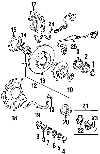

The t100 uses serviceable wheel bearings. Chances are, yours haven't been serviced in a while, they got loose, and now, whatever grease was left in there is being thrown out.
Here's a breakdown to give you a little better idea.

Thanks yeah the problem was the outer hearing was destroyed. The only prob I have now I can't get those spindle nuts which are 8 and 6 in that diagram to go back on.
